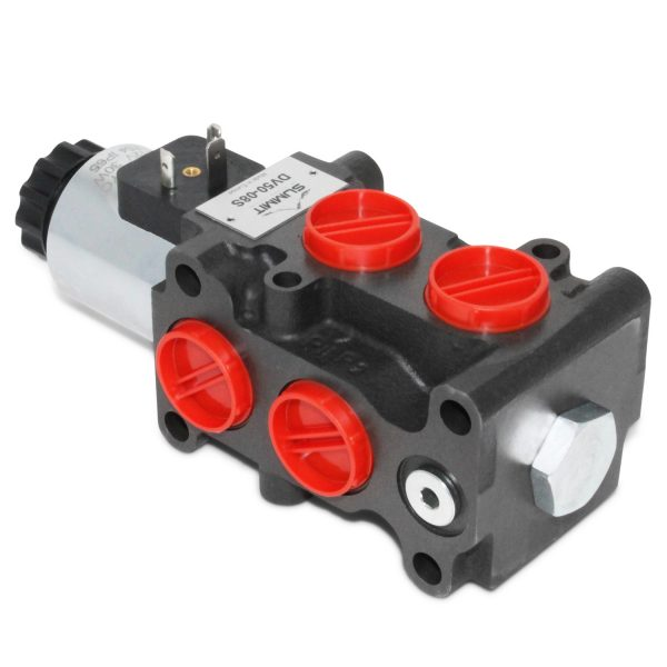

Summit has this little number for $100 you could probably make work.

Yea I've been doing some digging... Basically I only need two 3 way valves that I can just attach in between my thumb connection (T off). However the problem I'm running into is I don't want a lever sticking out as it's going to get snagged on something. I'd rather have a nut...
I don't think I even need to mount the 3 ways... my thumb connections are mounted on a plate, so it's pretty rigid if I T off there.

i have one of these 3 way diverter valves on my U27-4. I was considering robbing it for my new Takeuchi TB235-2, but for $200 I can get a pair of 3 ways from my local hydraulic supply house. The configuration is not the same and they have an arm to select the ports that possibly could get knocked when the arm is getting into trees or something else. I will simply make a bracket that will attach them to the excavator arm and hold the valve appropriately. If you get one with 1/2" NPT female ports, it's easy to rig the proper fittings to agree with your hoses. You should be sure that the valve is rated as high or higher than your hoses. Anything above 5000 psi should be adequate. That one from Summit looks like a good bet but the flow might not be high enough for some attachments on the L47. They make higher flow valves that are of similar design.

Update: I looked into this A LOT. I found that I can get a custom valve (similar to video above) from a shop or just piece together myself. Cost for a setup like that was more than the summit valve (also in this post), which seems more elegant so I went with that. It was about $250 for both sides of boom, but it's backordered till 1 week of march (fine with me as the tilt bucket I want is 4-5 weeks for production).

To add... the L47 third function GPM is 11.5 (on loader and on backhoe). The summit 20 GPM valve is 2x that so is fine. I think the M62 is 16 GPM at the third function... both are low, but are good numbers for 'low flow' attachments... you don't need or want 60 GPM for a tilt bucket or thumb and would have to get that reduced, but of course you want a lot of hydraulic brush cutter.
