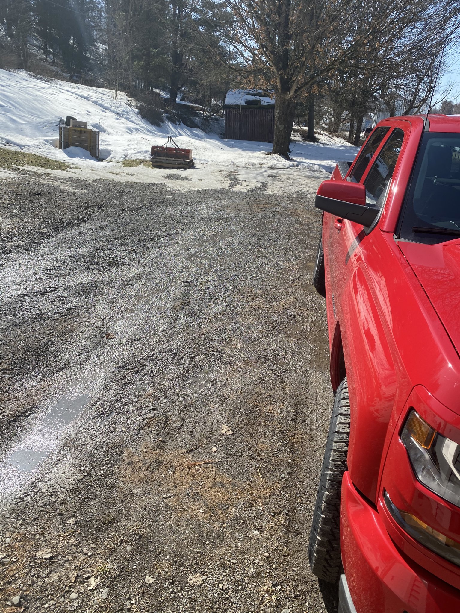

NCL4701 has some great suggestions.
This won’t show well, but beyond the box blade is a swale in the lawn heading right.
The BB sits in a high area that sheets water toward the garage, but everything runs under the truck toward the lawn. The road access is just behind the truck, and downhill about 40’.
It needs more work as some does run down the driveway just behind my bumper, but I’m catching most of it.
Most of that was done with some seat time and the box blade, with about 5 yards of fill where the box sits
This was a flooding rain a couple years ago before I made the last changes. You can see water running under the truck to the lawn, but still had quite a bit running down driveway.
