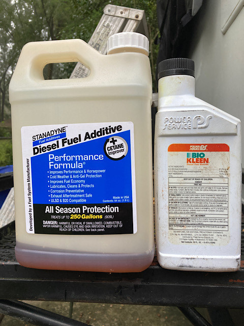

I use a bit more fuel at the farm but I have similar situation and the necessary extra fuel is stored in six 5 gallon jugs. Of course being in the South I have no gelling but I do add two 'additives'.
One oz. of the Standyne and one teaspoon of the BioKleen per 5 gallon jug.
As mentioned by Bmyers above everyone has their favorites that they trust, this just happens to be mine.

I use a bit more fuel at the farm but I have similar situation and the necessary extra fuel is stored in six 5 gallon jugs. Of course being in the South I have no gelling but I do add two 'additives'. View attachment 66837
Both of those are excellent choices!
