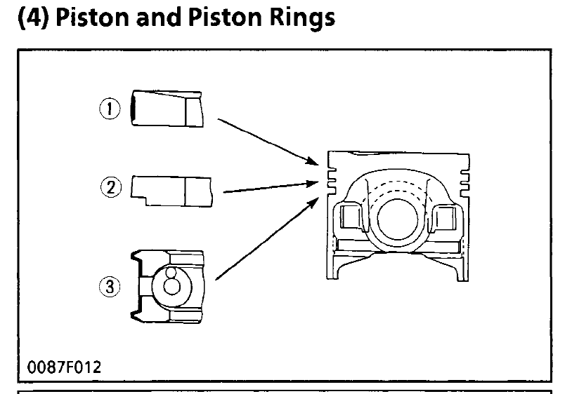

I'm betting you put the ring in upside down.
The to ring is a wedge.
And if you did you more than likely damaged both the ring and piston.

Thank you for posting this follow up! And thank you Wolfman for posting the piston profile diagram! Learned something new today.
