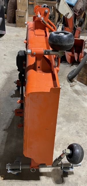

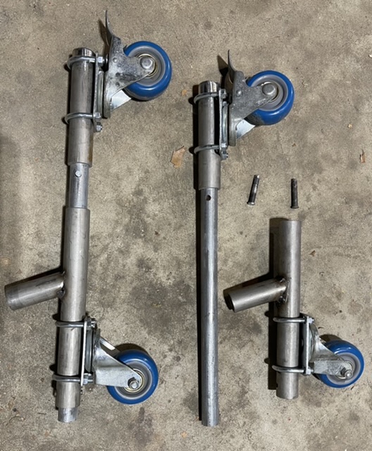

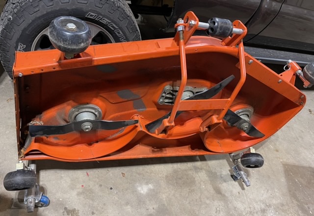

Stole this idea. Should have made this a long time ago. No tools needed. Just use the pins from the deck wheels +2 additional pins. Only thing I may still do is tack the u bolts to the rod so they won’t rotate. You can only tighten them so tight and the casters plate wants to bend. One caster wants to rotate. Other than that, works great. Had the casters and stainless 1” pipe. Got 10’ of 1” rod for $20 and about $20 for the u-bolts.

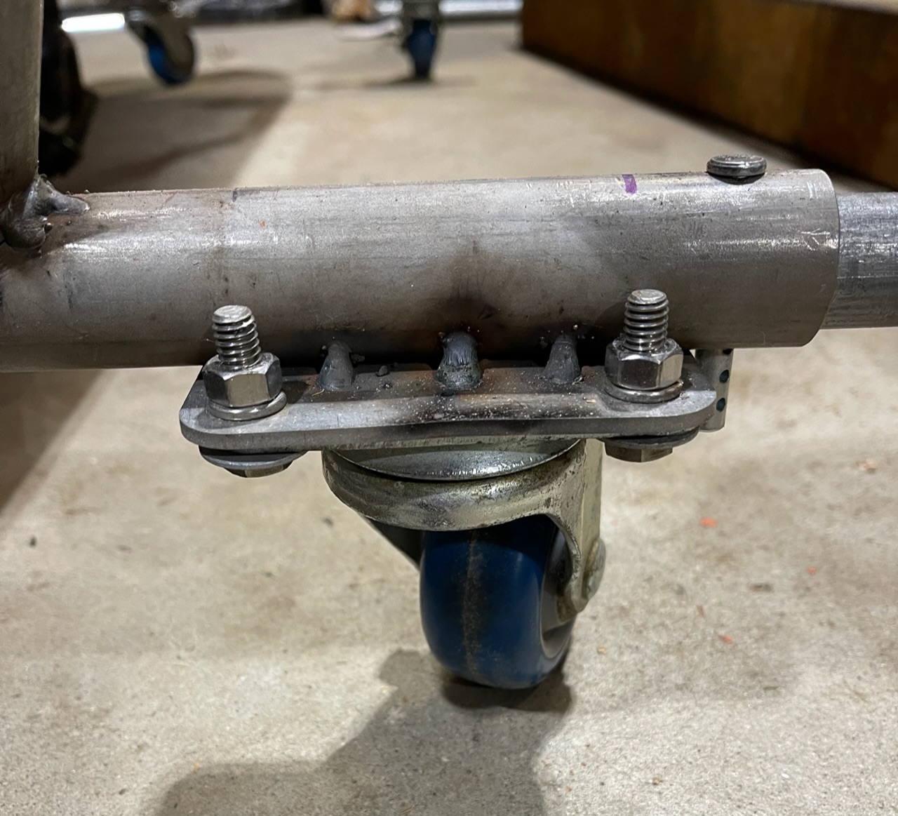

After you tack the ubolts, put a second nut on each bolt end to tighten the caster to so it doesn't deform, So that you sandwich the plate between them.

The u bolts idea did not work as they would rotate. Had some stainless plate so I made 4 plates and tack welded them to the rods and bolted the casters to the plate.
View attachment 92028 View attachment 92029 View attachment 92030

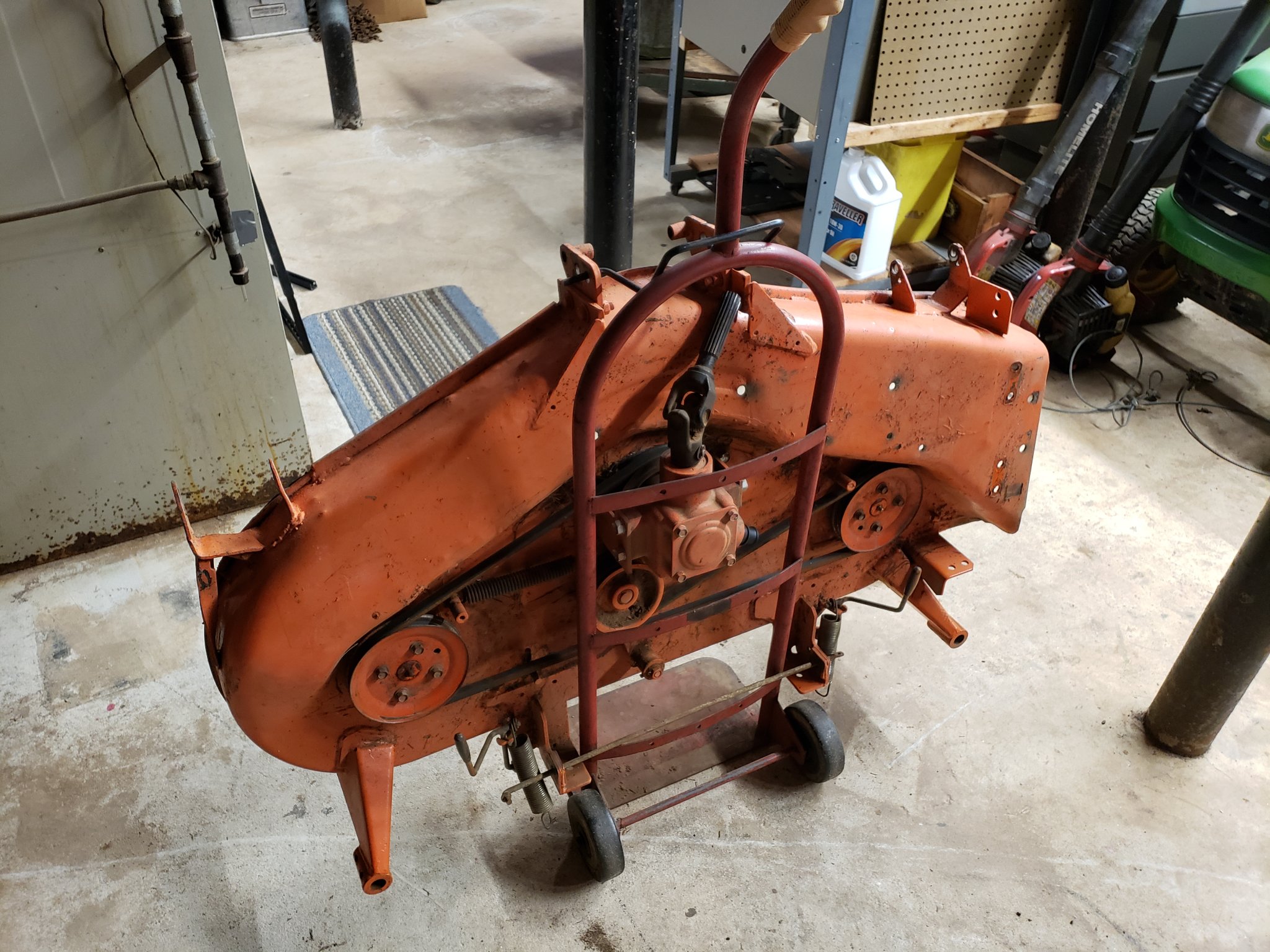

My decks are small enough for a hand truck. Makes easy repairs to blades and bearings. Just lay it on top and stand it up.
