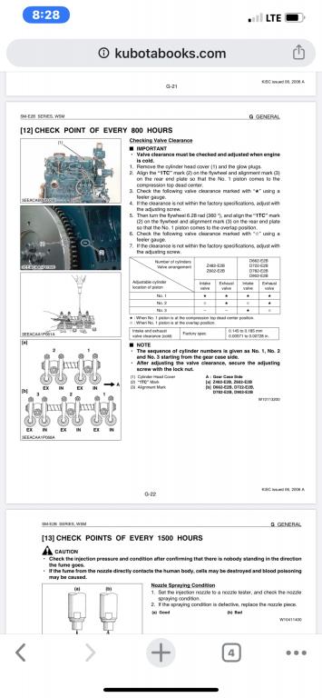

Anyone have what the valves should be set at? I've got a B7300 that needs the valves adjusted.

I always have my dealer set my overhead and spray test the injectors at the same time but then mine require removal of a lot of stuff (accessories) in the way of the overhead (getting the valve cover off) and the loader frame must be removed on mine (right hand) to access the timing marks on the flywheel. Tapping when at operating temp is indicative of loose valve clearance.
