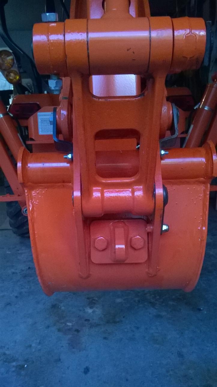

I have two of Kennys bolt on hooks on my bucket and had a third hook welded on the back of the BH bucket.

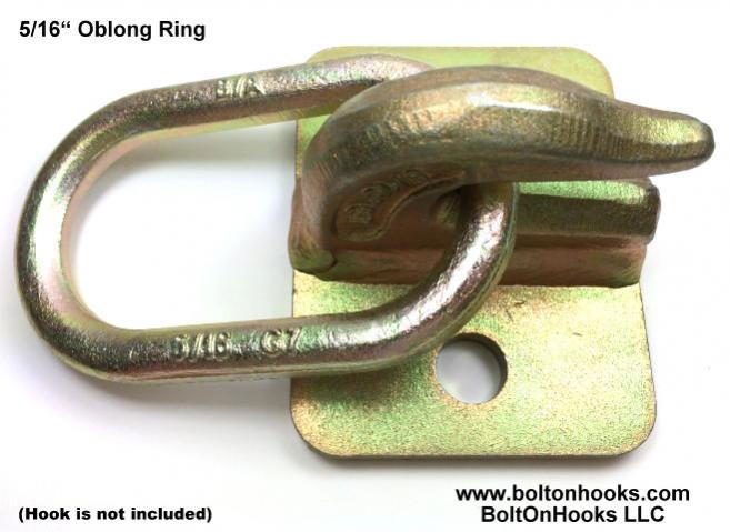

I also got a few of Kenny's oblong rings for rope to hook connections.
