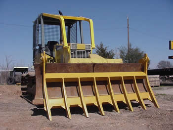

I tore every up the same day. I’m clearing 45 acres of mostly 2 - 3” trees. There are lots of larger ones but I’m leaving them. I wanted to hold off using a bulldozer because it takes out a lot of topsoil. But looks like I’ll hire one and use my tractor to clean up afterwards. This is the first thing I bought for cleaning up this land. It has a front end loader and a Woods brush cutter.
A good operator using a dozer with a brush rake instead of a blade can knock down and pile brush with a minimum of dirt in it. Once piled, he can roll the pile which shakes all the dirt to the bottom anyway.
