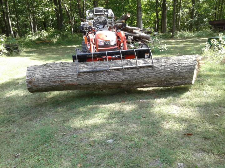

One of the main arguments that people seem to have with the lighter duty land Pride grapples is the lack of teeth in the tines. logs slipping around, bad grip on stuff, etc.
The complainers are probably trying to grab too many logs at once. Can often get 3 logs in the 8" dia. range. as far as grip my sgc0660 is holding 1500 or so pounds
