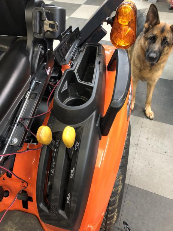

Does anyone know how to remove the cup holder-box on the left side of the BX23S? I can’t access the rear bolt and I can’t get the levers through the narrow slots.

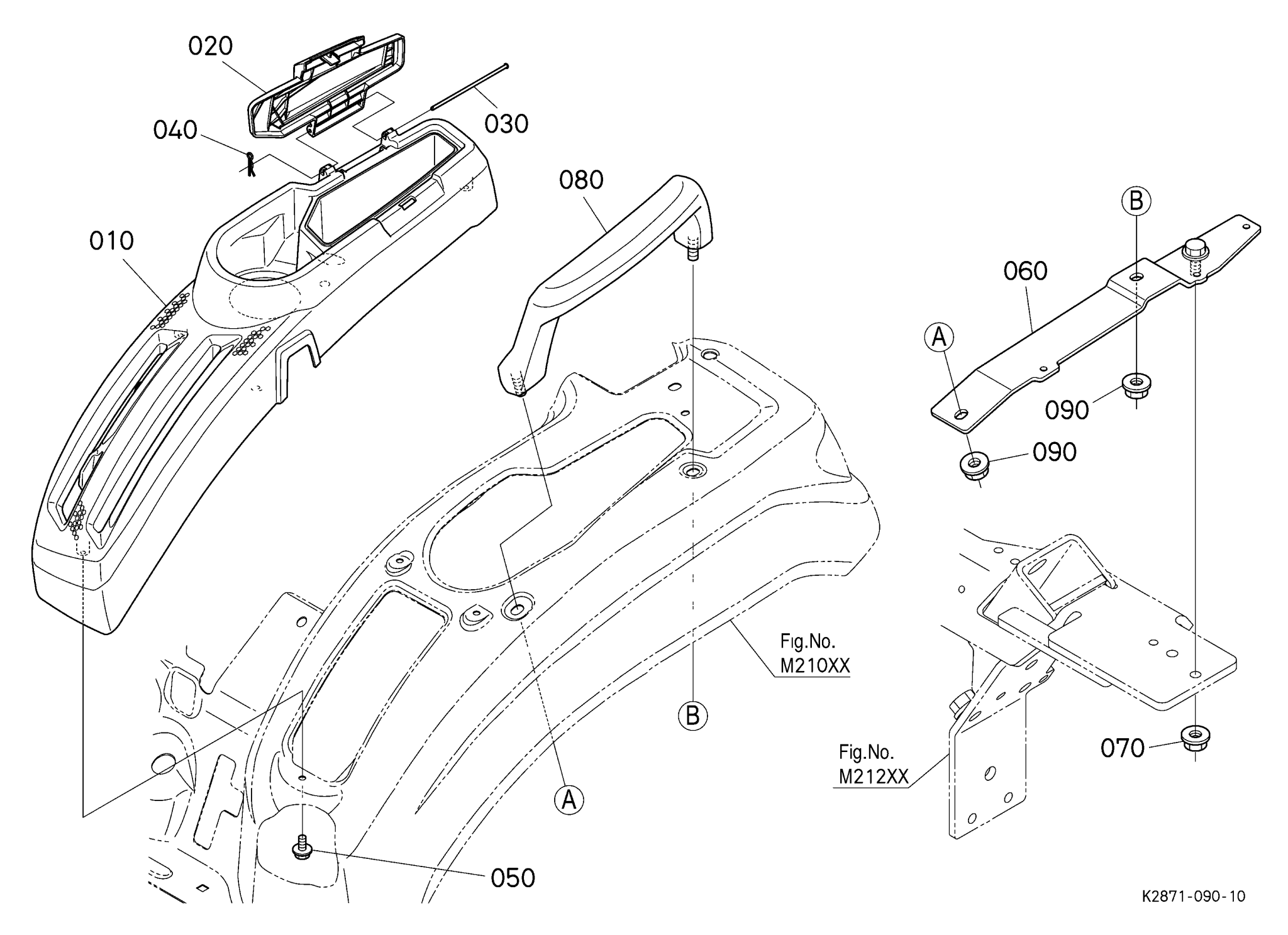

Are you looking to remove the entire plastic piece? If yes, on my BX, the bolt are under the fender. It's kind of a pain with the rear tire on, but doable. If I remember correctly there are bolts that run up into the handle and then maybe one or two more.

Yeah, removing the whole piece. The problem I see is the very last bolt in the rear. It***8217;s between the tank and fender. Also, the levers...how do those go through the small slots? I have looked everywhere and I can***8217;t find anything that talks/shows it

I’m trying to remove the console. The piece that has the cup holder, storage box and power output. There are 4 bolts. One in the front, two in the sides and one in the rear. I can’t figure out how to access the one in the rear.

It has been 8 months since I did it but, if I am remembering correctly, I ended up loosening the rear of the fender. Once the fender was loose, I managed to get to that last bolt by lifting up on the fender. Even with this, it still wasn't easy.

I think that this post means you remove the plastic knobs off of the metal lever, then remove your plastic part over the metal lever.

Cannot comment on cup holder, but the knob handles could be easily removed. Provided they are not glued on.
On my L3301, all those orange & yellow caps have a small hole in the top of them to purge air when installed. Simply hold an air gun over them, and as you blast in the air, pull/wiggle them off. If cold or age-hardened, warm up with hair dryer first to make pliable.
