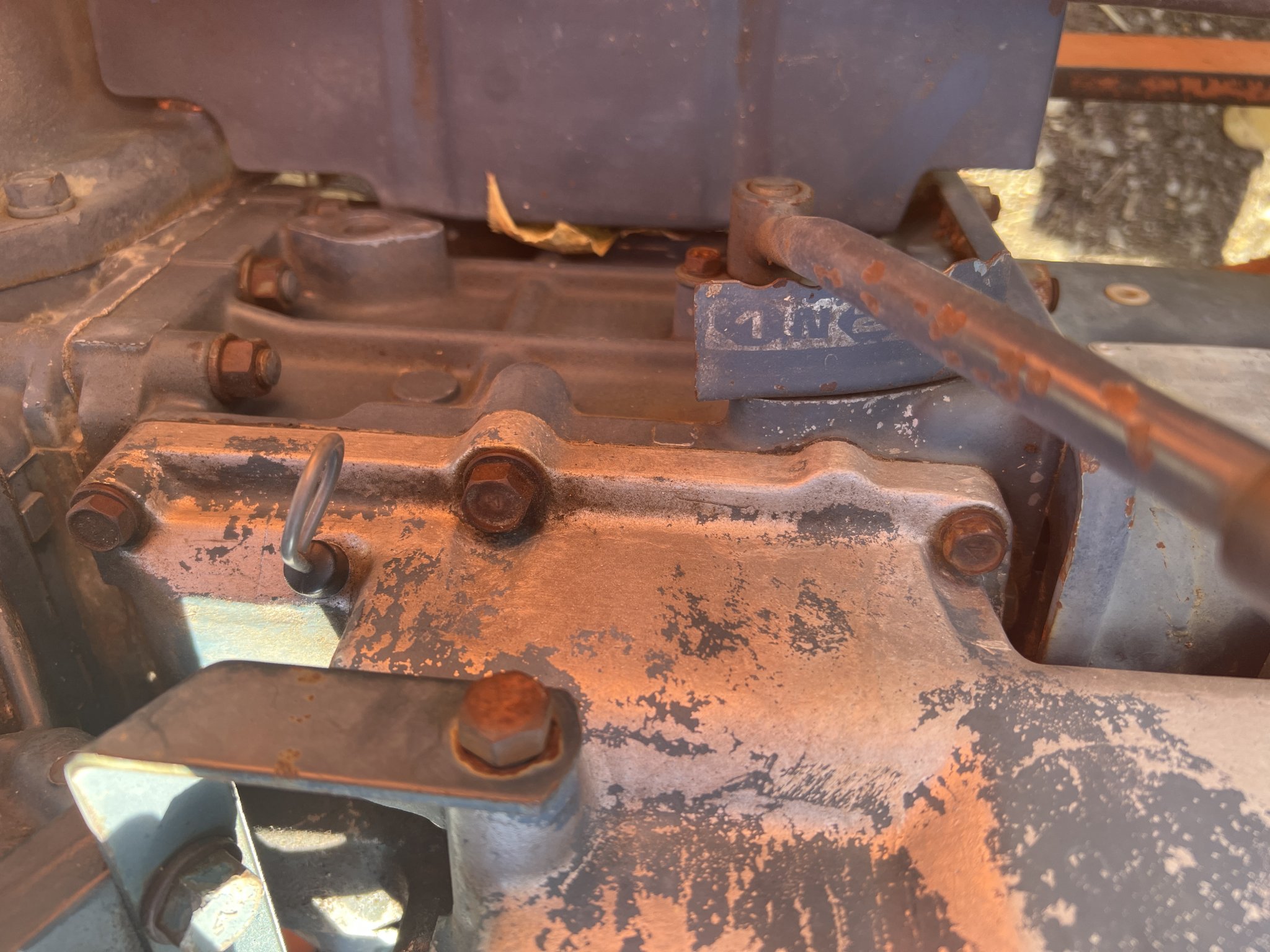

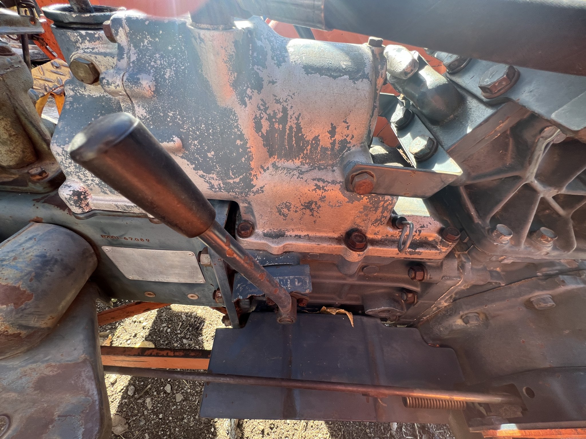

I have a B7100 with a creeper gear on it. I have scoured for any literature about the creeper and have had little luck. Does anyone have any information they can share. Even if you have pictures of the original decals. Mine are too gone to see. Thanks in advance.

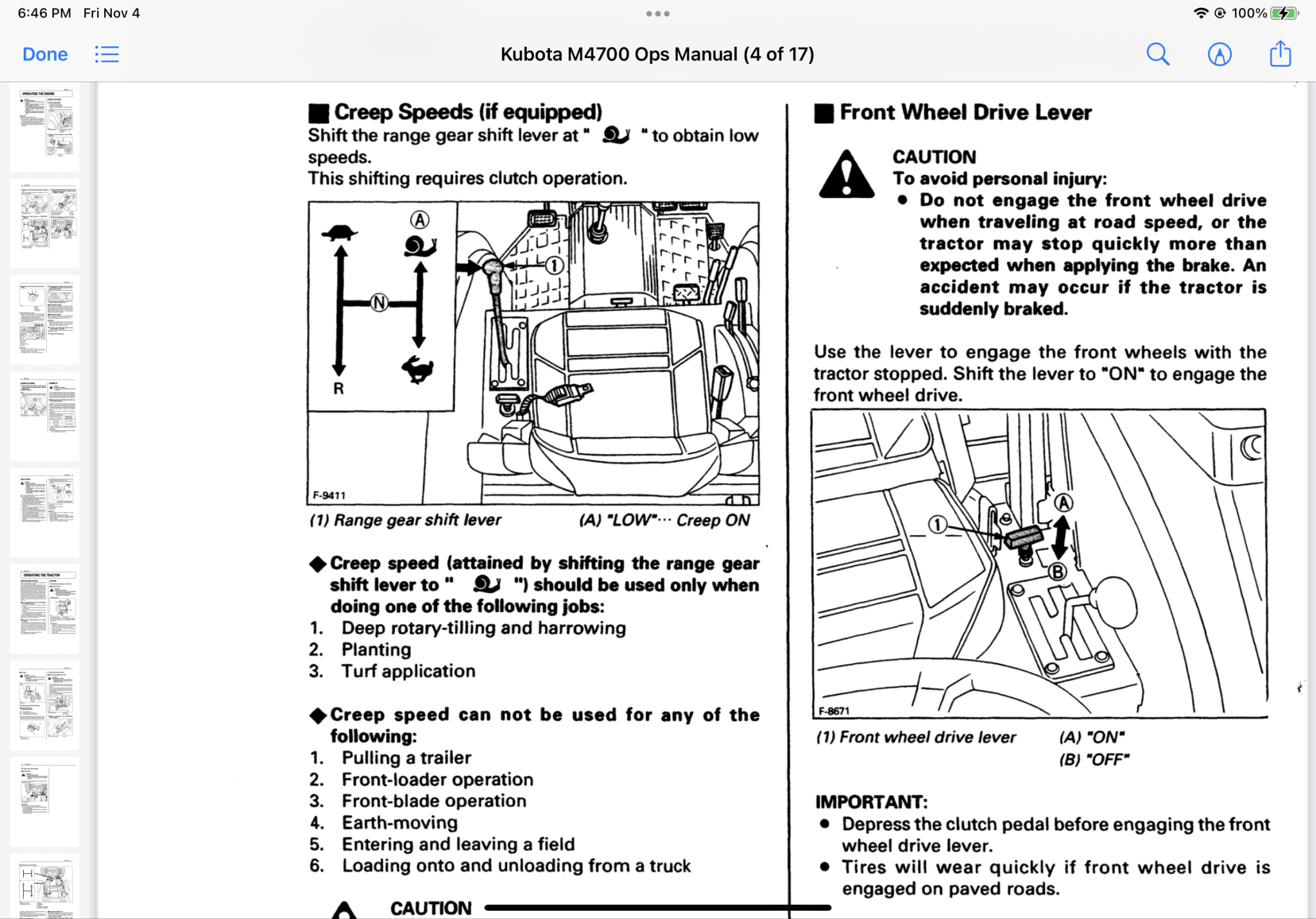

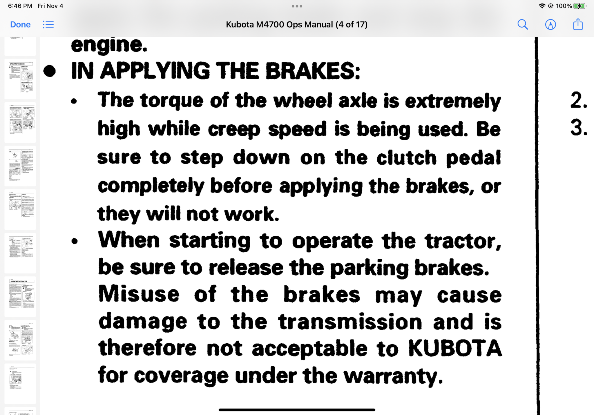

Here are two screen shots of the Owners Manual of my tractor regarding “creep” use. (Note that they specifically state that high torque results from use of creep.)

Interesting.
So Kubota concurs that high torque forces ( a by-product of compound gearing) are already at work and warns against using the tractor in ways that will contribute to the strain.
In other words, the creeper gears are the weak point and the purpose of them is to provide for slower forward/reverse motion of the tractor, NOT to provide additional bulldozer like torque (to be used indiscriminately).
In essence they are saying in certain applications, the creeper gears are useful, but let the tractor do the work and the creeper gears move you SLOWLY along. (which is what lets the tractor do its work without bogging or undue strain).

Maybe I am reading it a little different…Seems to me that the cautioning to protect the brakes and transmissions…and I think the tasks they are recommending it generally minimize shifting (and change of FWD/REV) and brakes.

No effort to 'protect' the brakes. They are simply saying the torque developed will overpower the brakes (if brakes are left on or the clutch not first depressed) AND that the extra strain that places upon the gears is something to be avoided.
Again, the purpose and idea for the creeper is to provide very slow tractor speed(s). It was NOT to create torque (potentially too much torque is the issue here) and the cautions set forth.
In so many words, they are saying: Let the tractor do its work. We (Kubota) have provided a means for that 'work' to be done at slow speeds....so the tractor CAN perform what is being asked of it...while not breaking anything.

Wow, this is cool. I did not realize this box existed for a B7100.
I have used a trencher with my b6100 but it has its own axle and hydraulic drive motor for creeper speed (tractor stays in neutral) so it is pretty universal other than requiring hydraulic flow (but not valve, the valve is onboard).
A b7100 isn't heavy enough to use any more gear reduction than it's got. It will already sit and spin all 4 tires in 4-lo at a fairly low throttle. They just aren't heavy enough to use 'more gear' for pushing or pulling.
I can absolutely understand why you wouldn't want to try and push or pull too hard with the creeper on a larger tractor!
But the other thing to consider is how the creeper is implemented here. It is essentially bolting down in place of the transmission's top cover. If it is using a chain down to a sprocket in the stock trans, that would be cool but doubtful because then you'd likely have to tear down the original trans to install said sprocket.
If it is simply engaging one of the stock gears, which is more likely, then any torque across those gears creates a spreading force which is trying to push that whole creeper assembly off the top of the trans. You likely could not make the stock attachment points, or the creeper housing itself, strong enough to deal with very much spreading force across those two gears, to avoid damage.
Compare that to many other tractors' creeper gear sets which are installed 'in-line' with the stock trans, within the frame/tunnel, which would be far more likely to damage the downstream components than to break themselves open or off their mounts. The way this one is mounted is relatively fragile compared to that.
Thanks for posting about this!

That offers some insight i had not considered. I have not removed it but am going to so i can have a better understanding of the additional gearset. I think you are right in saying it is not chained down. im going to attach a picture showing how it bolts down. These creepers were originally put on tractors that came with a trencher. So it had a pretty specific use. I could see it being useful when running a tiller or woking in confined spaces as well. The 7100 does spin tires easily though.
I am curious if there is a neutral for the creeper. So i can use the tractor with the normal transmission and bypass the creeper or if it is always running through the upper gearset. I simply like the extra height of the shifter and its neat. I cant find any information and the decals are long gone. I can see why the potentioal is there for damage and why it could be fragile. I have read in several places that they were overbuilt and pretty stout. But I have no experience or knowledge that backs that.
