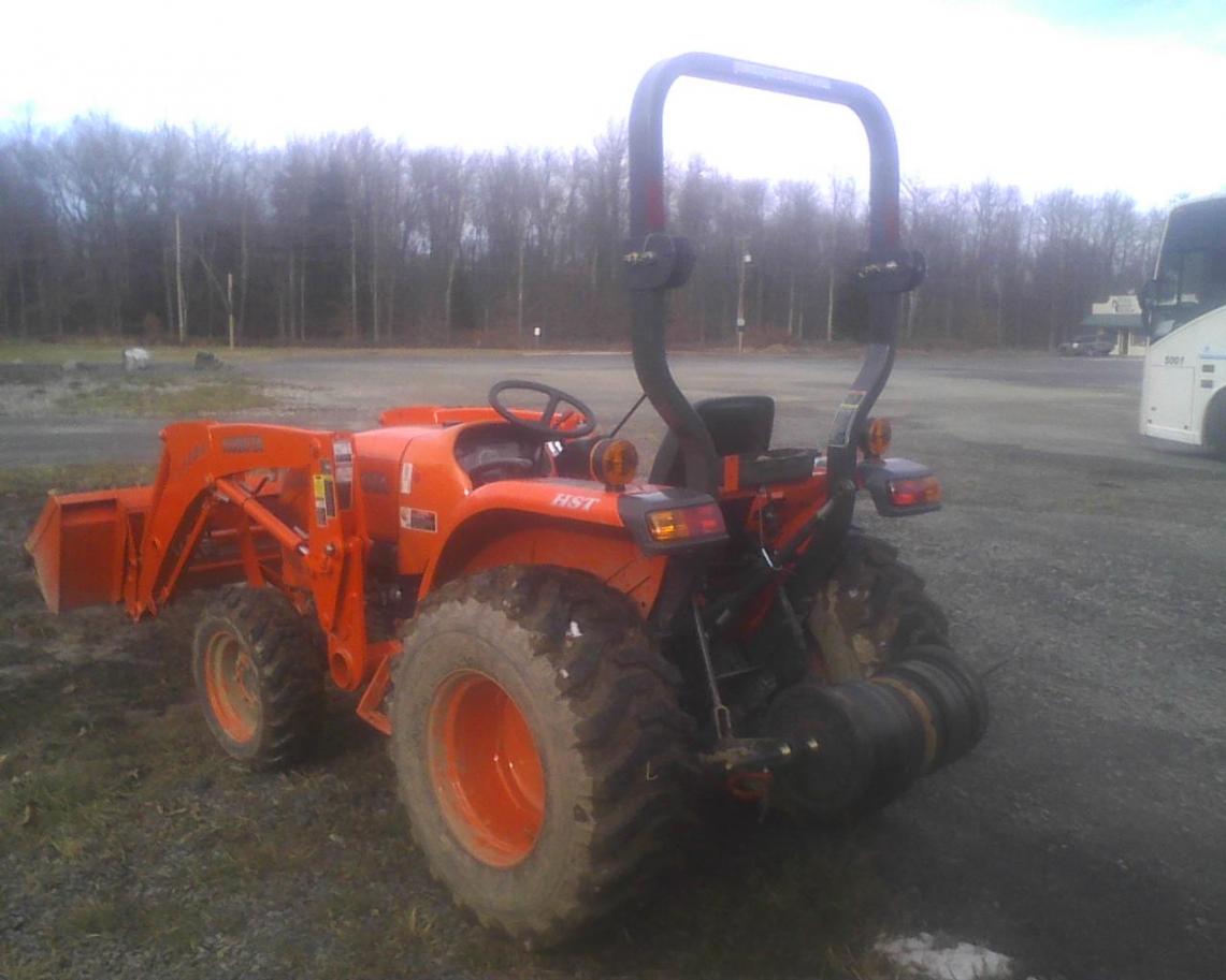

I use a box blade with extra weight added. Or a log skidder I made with
wheel weights added. My 3800 does best with 800-1000 lbs on the 3 pt.
Wheel weights and tire ballast are great for traction and stability, but do
not take the place of a counter weight on the 3 pt hitch.

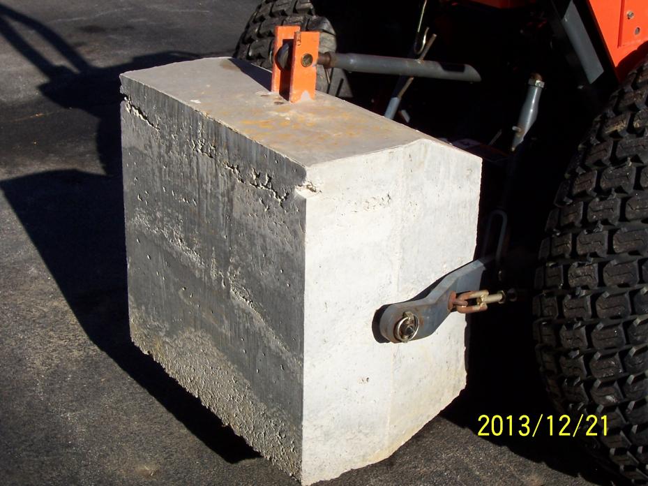

I used a scrap concrete block from a concrete plant. They sell the 18"x18"x5' blocks for around $20 (cheaper than buying concrete). I hammerdrilled through the block and broke it in half, and then drilled a hole through the middle to fit a rod through which goes through my 3pt. Works very well and is compact (tall but narrow).
The home-made ballasts are nice because people add on the hitch feature, a 2" receiver, extra room, etc. I just wanted something cheap and easy to install.
