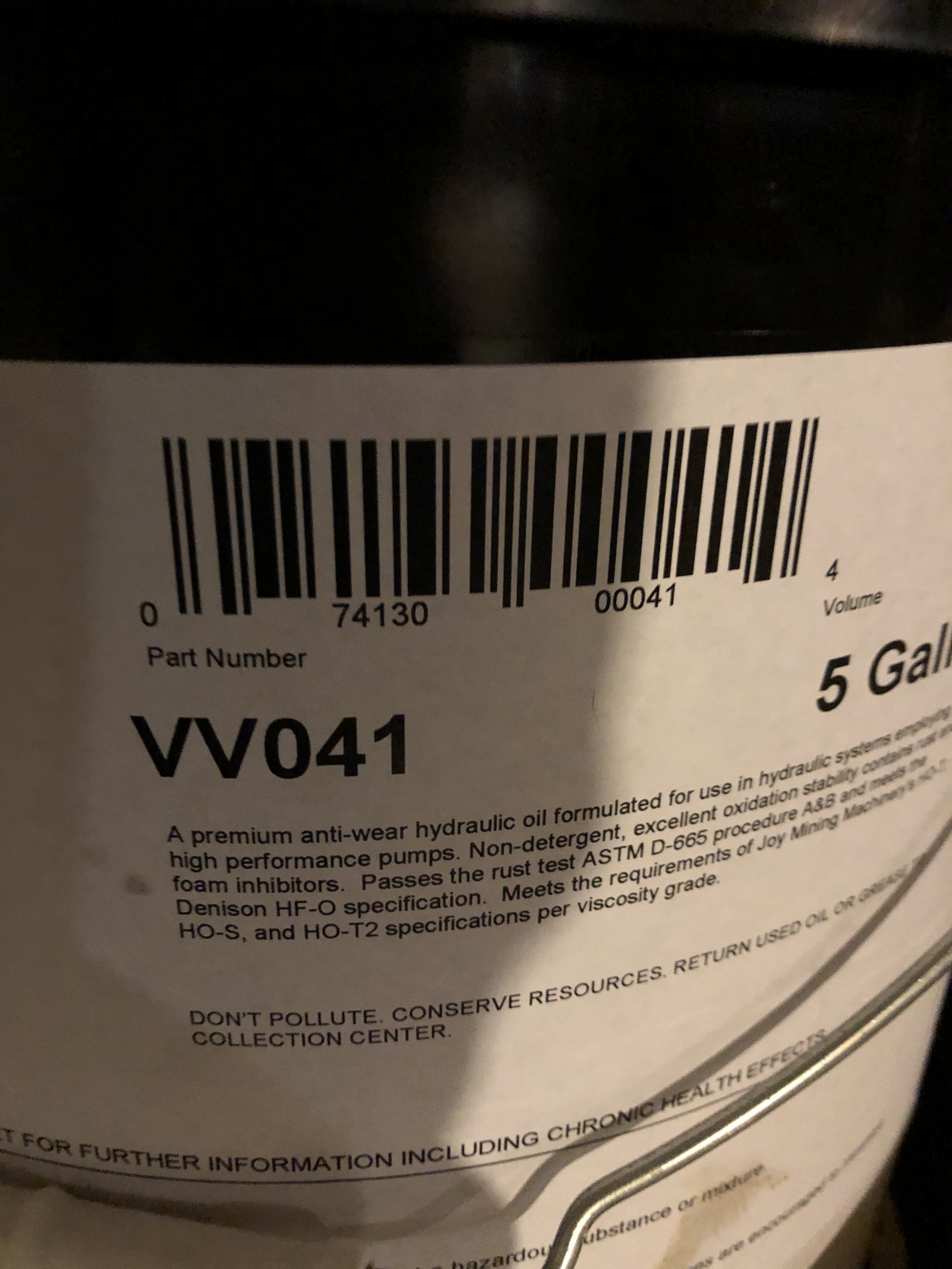

When I got my WC68 I was so particular about what went in my Kubota HST (still am) I decided to call Woodland Mills to ask them EXACTLY what to put in it. The tech service guy was very nice and understanding but said something to the effect of it’s not a HST type super sensitive thing, just put 5 gallons of decent ISO32 in it. I ended up using The Valvoline in the pics but not saying that’s ideal or better than anything else.
