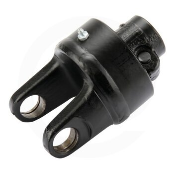

My research shows a replacement yolk for the PTO shaft, just remove the splined yolk from the UJ and fit the replacement with built in overrun clutch. Any good?? It's a lot less money than the one similar to the one in the link, and no need to cut the shaft down. What do you think?
Trevor
7,102
2,535
Sounds like it is a good option but just make sure it will do the job. I am surprised that it can be made in the same space as the original yoke but it is a good idea.

Hi, Are you referring to the one in Big G's link above. I suppose you are correct, if I fit the one I pictured, its only good for that one implement. I hadn't thought of that. :unsure: Precisely why I joined this Forum:D

Hi, I know it's 3 years since I posted this, I thought I'd do an update. I fitted an overrun unit as per the link above, I was always concerned by the noises it emitted on occasions. I kept it well greased but today it spat it's dummy. When I took it off it had broken up internally. Not too impressed that I've now got to replace it, this time with a different design. Hopefully it'll last a few more hours!!
