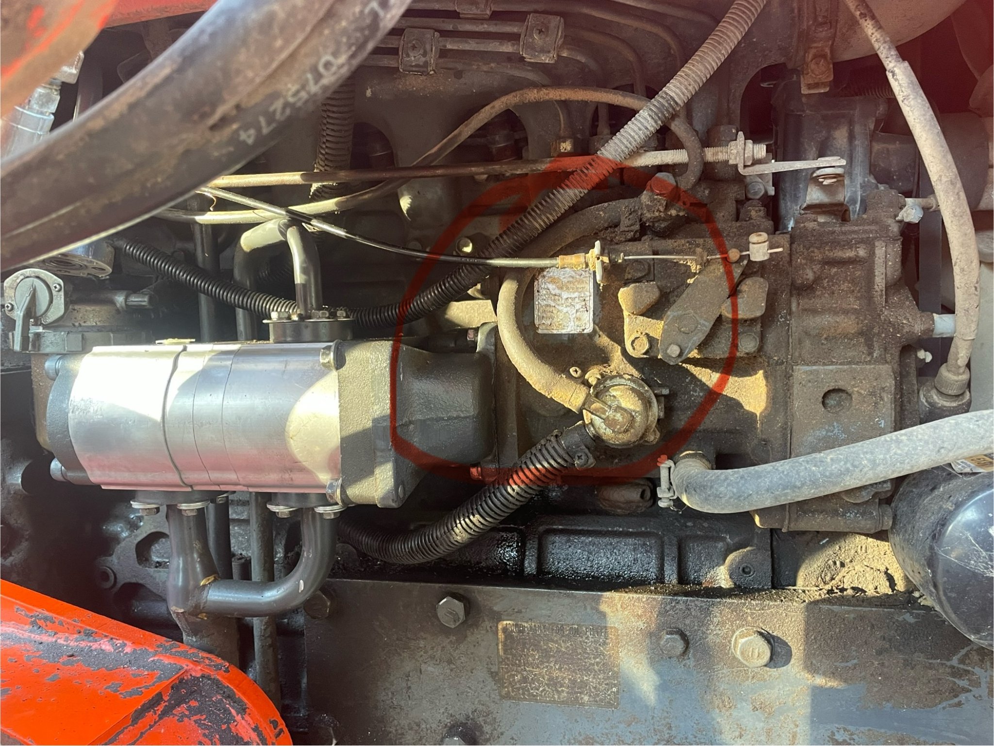

Just in case it helps anyone: I got a Chinese ebay pump for my M5400 and I finally got to mount it today. It wasn't an exact fit, the bolt pattern on one of the exit lines was wrong also all the suction line bolt holes had to be enlarged, thank God the flanges on the lines are aluminium and it was easy to drill. Still a lot of aggravation due to the limited access. Also the face plate is too thick... But got it done eventually. And the hydraulics worked right off the get go. Will see how long it lasts. It was $320 shipped which was hard to say no vs $1700 on messicks.

It looked very close to the original but not a perfect fit.
I have dealt with parts like that on a car. Looked close. Smelled close. Once it was tone to bolt things up.....not close enough. To me, if they can't even bore holes right, they might not get the rest of it right.

I am still not clear on what did not fit.
The mounting faceplate was thicker, setting the in and out ports back. The bolt pattern for one of the outs was wrong so I had to drill the flange with 4 additional holes. It was tough to get right because of the limited access. I eyeballed the locations and adjusted with a dremel. But it works and no leaks.

Port bolt circle missmatch sounds like its more generic than application specific. Or crossed over from some other application.
