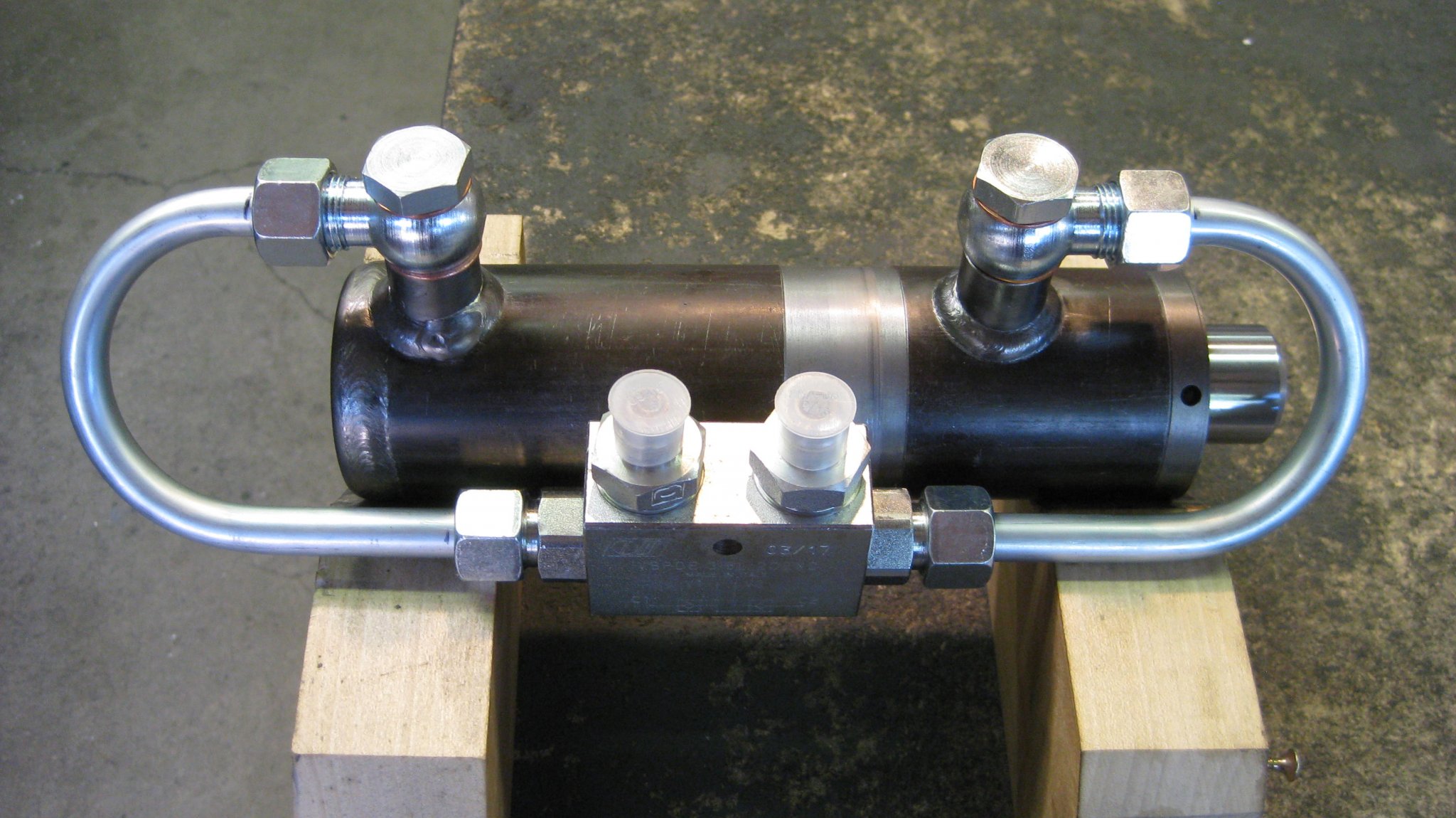

Almost all the ones that are built onto the cylinder have custom hardlines fitted to them when they are built. I have seen some fitted between sections of straight tube with banjo fittings on the cylinder ports, but it looks highly tedious to piece together and replicate. I would buy a cylinder that already has it and find a new use for this one!

Your biggest issue is going to be the #6 ports. The banjo bolts for this application are not mass produced.
If you are a machinist, not a problem.

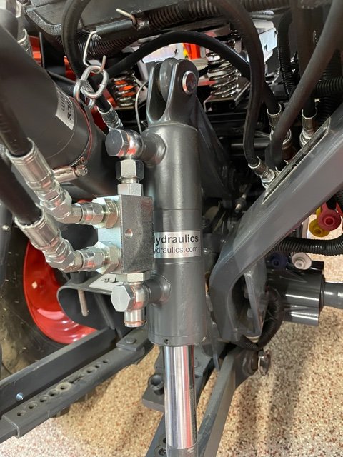

The picture with the u bends is on a 3" stroke cylinder, so it can be done.
The picture of the side link with the DPOCV is a 4" stroke unit on a B series Kubota.
The least costly way is probably just put a small on-off hydraulic rated ball valve on the cylinder.

I believe two valves would be needed to mimic what a double pilot-operated check valve block would do.
With only one manual valve as shown in picture #2, the cylinder would be locked from extending, but could still retract, if leakage through the control valve were an issue, which it always seems to be to some extent.
Without stopping leakage from the cylinder end (vs the rod end) the only real force holding the piston in place is whatever results from a vacuum being pulled on the rod end of the piston, caused by a force pushing on the cylinder rod.
Just something I came to realize after reading threads here at OTT.
Unless someone has figured out how to overcome gravity, with the rod end blocked, the rod WILL NOT extend.
Yes if there were a constant up pressure the rod could retract. 99.9% of the time that simply is not the case.
Point being, in real world use, this works to prevent adjustment from control valve leakage on a side link.
Granted the rod end will not extend, as I stated also.
With a tilt cylinder you are certainly correct there is likely no significant upward force to be an issue.
I guess I tend to think beyond a given application. Someone could view this thread and think one manual valve would work in every case, which is unlikely at best.
Point was that a single manual valve does not duplicate a pilot operated check valve set up that uses two check valves. Nothing more than that.

The picture on the right is what I am interested in. I think I can overcome the #6 port if I can find a DPOCV that is small enough.
