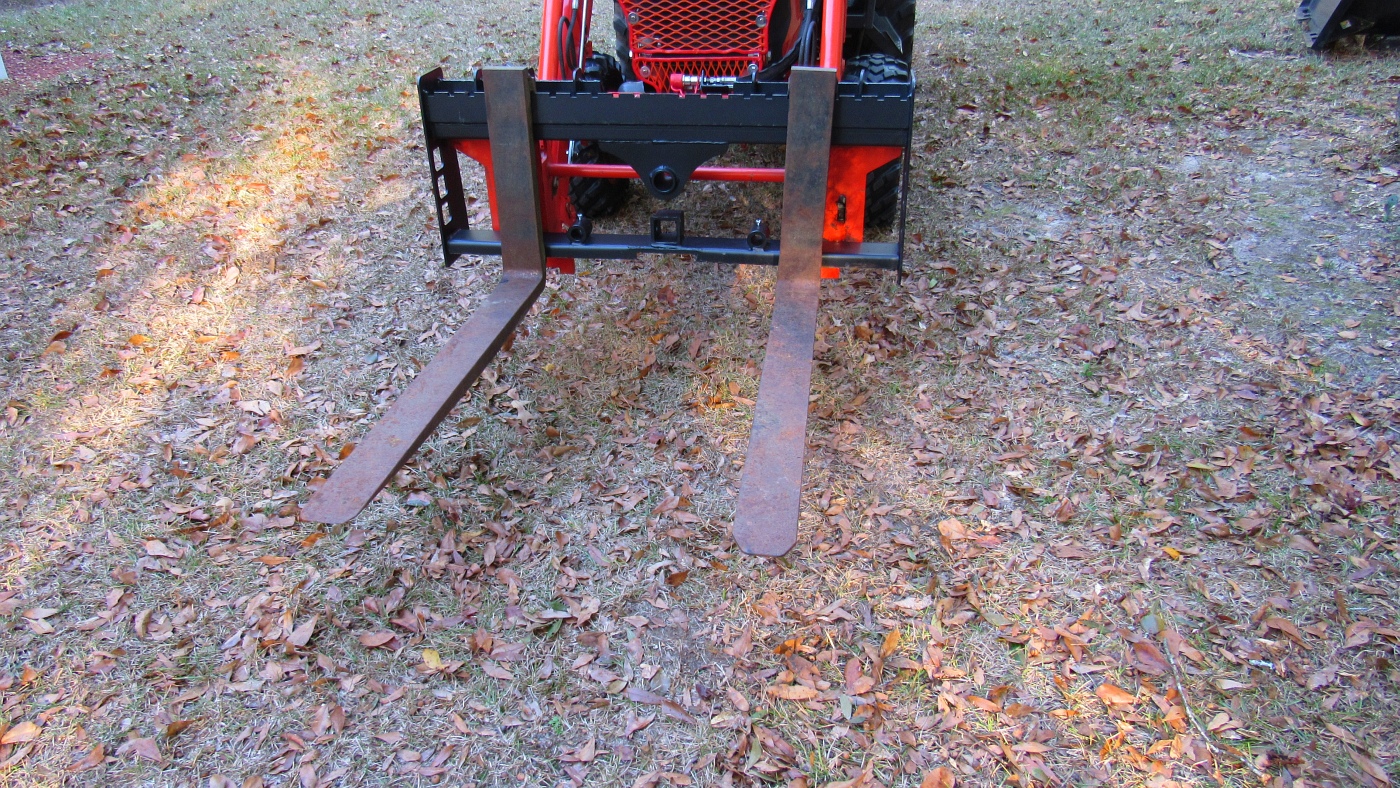

Say what you want about cheap china stuff or Vevor. I have got some crappy quality stuff from china but so far everything I have purchased from the Vevor name has been low priced and quality built.

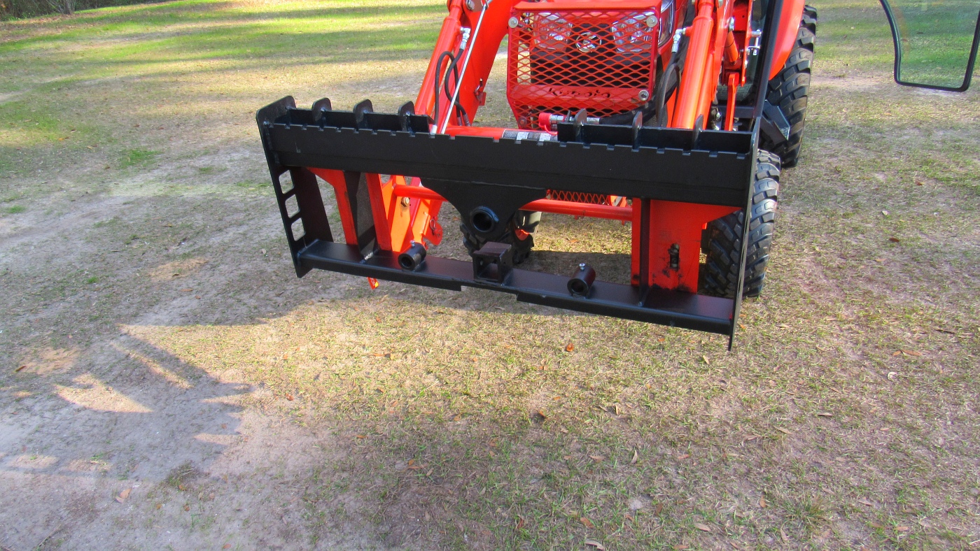

This frame came in a Vevor box even though it didn't say it was Vevor brand in the ad. It fits my loader like a glove. The standard pallet fork forks went right on. The carriage bar is even chamfered to match the chamfer in the pallet fork hooks.
We'll see how they hold up but I am confident it will pick up anything my loader can handle. Looking at the pics I think I might reinforce the bottom center part before I put any stress on it.

I have a cheaper than most titan attachments one and the only issue I’ve had is the bottom flange will bend if I put too much down pressure on it. When it happens I have to bend it back or moving the forks side to side becomes a chore. In the products defense it is meant for lifting not down pressure.

Am I right that the forks are hooked into the top rail and simply lean against the bottom rail?

@Hugo Habicht The forks also have a bottom hook. You have to set them on in the center and slide them outward.
I suspect I am going to weld a piece on between the 2 inch receiver and the hay spear receivers to make that area a little stronger.
@L35 I had made a homemade set of forks from channel iron and bent one the first time I used it by pushing down with it. I repurposed the plate I used for that project to mount a sickle bar mower on.
These forks I bought off Market Place are genuine solid 4000 lb forks that weigh over a 100 lbs apiece.
