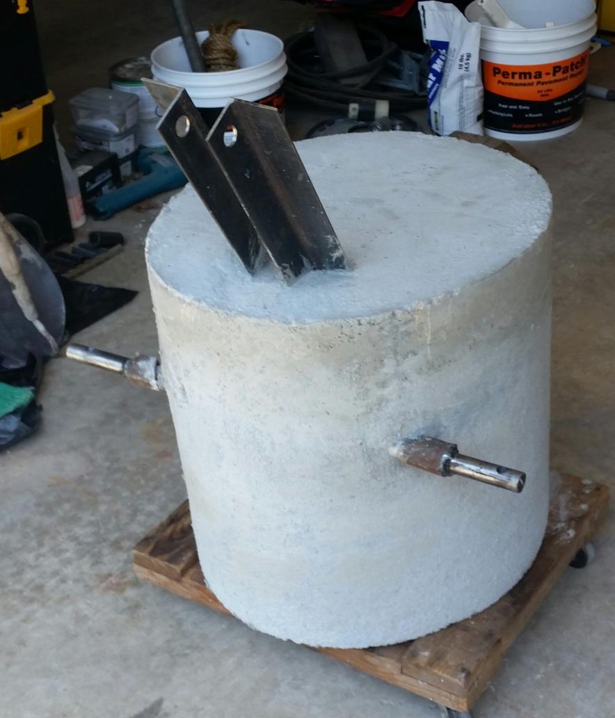

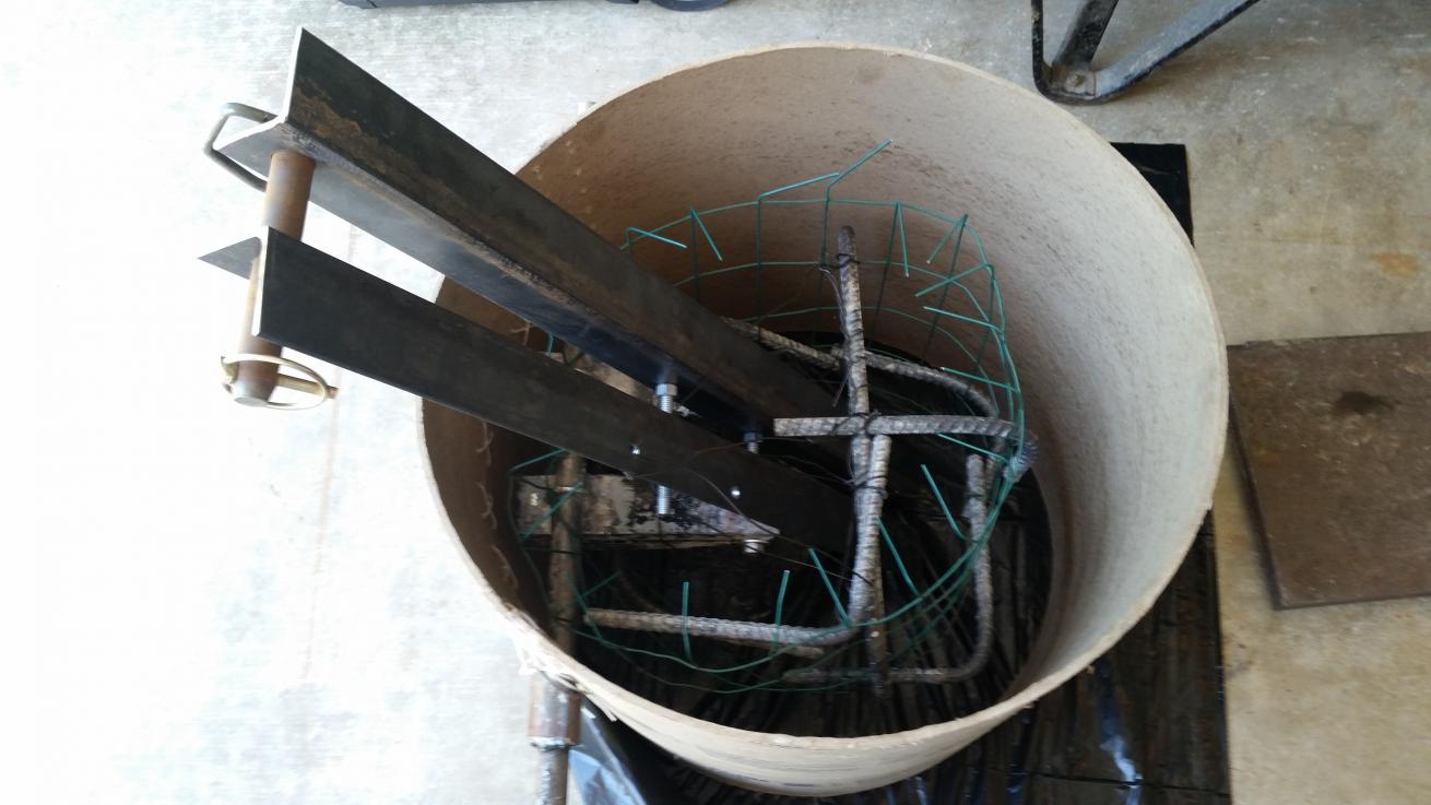

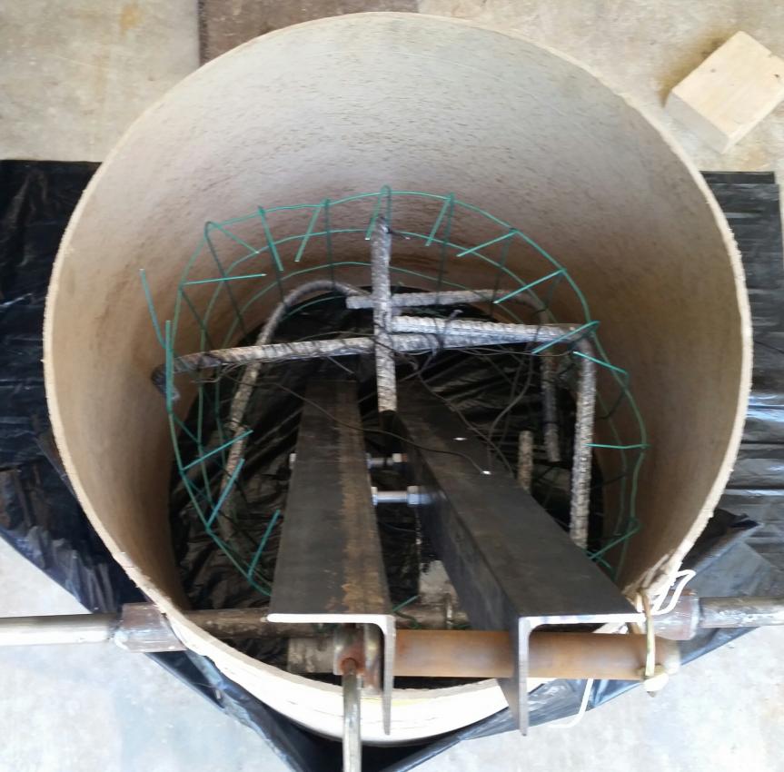

18 inch concrete form 4 - 80 LB & 1 - 60 LB bags of sakrete concrete mix. 7/8 inch steel round stock for lower hitch arms 2 - 2" x 2" x36" angle iron for upper hitch arm plus 4 - 2' lengths of rebar and some coated fence wire for a total of about 400 LBS. I have a furniture a furniture mover with wheels that I set it on when I remove it from tractor to move it around and install easier. Should have taken some pics with it installed but have my RMM on now.

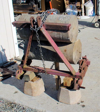

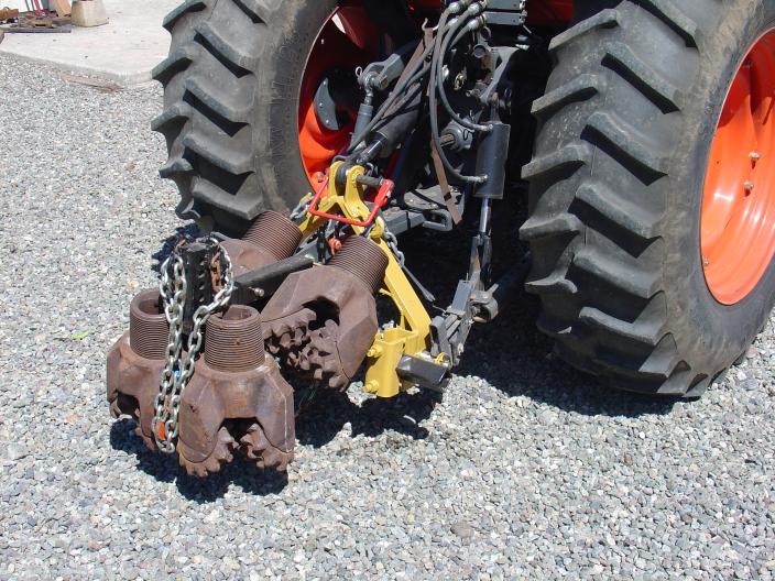

The real advantage of your design, besides the counterweight issue, is that it is so compact and close to the tractor.
While "close to the tractor" will lose some counterweighting ability, it won't interfere with backing up or rear clearance much. The round corners are so much better than a square prism design.
WELL DONE!
Here are a couple of mine made from old A-frames.

I like it! Been thinking about doing something similar, since I currently use my box blade as a counter weight, and it's unwieldy. I was planning on using a standard drawbar as the horizontal hitch mechanism, captured the way yours is. But hadn't figure out the top link part, where you have a nice, easy solution.
A couple questions, if you don't mind: I don't have any experience pouring concrete--what did you use to mix it and then pour it? Any issues with it seeping out of the bottom or through the side cuts in the tube?
10,576
7,733
Can't answer your last question, but as far as mixing the bags of concrete, it's pretty easy :D
Dump one or two bags of ready mix concrete into a wheel barrow. Add some water and mix either with a hoe or shovel. I use a shovel, and just shove it underneath the mix, and then push down on the handle. Just keep adding water a little at a time and mix till its the consistency of peanut butter :D
If you have a cement mixer, it's easier. Just dump the bags into the mixer. Turn the mixer on, and then add water till it reaches the consistency you want ;)
With it being the consistency of peanut butter, if you have a couple of small holes in the form, it won't run out :)

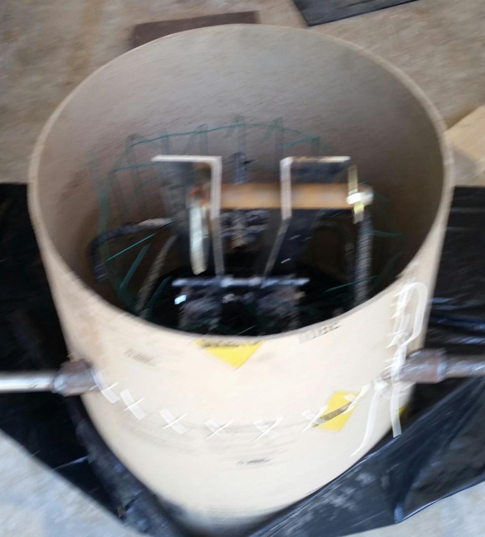

Mixed in wheel barrow make just a little wet, just set form on floor with plastic under it. The steel rod had two pieces of angle iron welded to it horizontal to the ground then I bloted the 2 pieces to that at an angle to form the upper third point. Hope that helps. If you don't have access to a welder you can use u-bolts to connect angle iron to 7/8 rod. The pic of form isn't clear but I had to drill the holes for the rod then cut form to insert then lace back up with string. Then on the inside I used masking tape to seal against any leaks. Hope that helps.

Thanks! I think that's all I need to know. Making one of these is definitely on my to-do list. I'm picking up a quick hitch Friday, and will want to base the design on its dimensions to be sure it's compatible.
