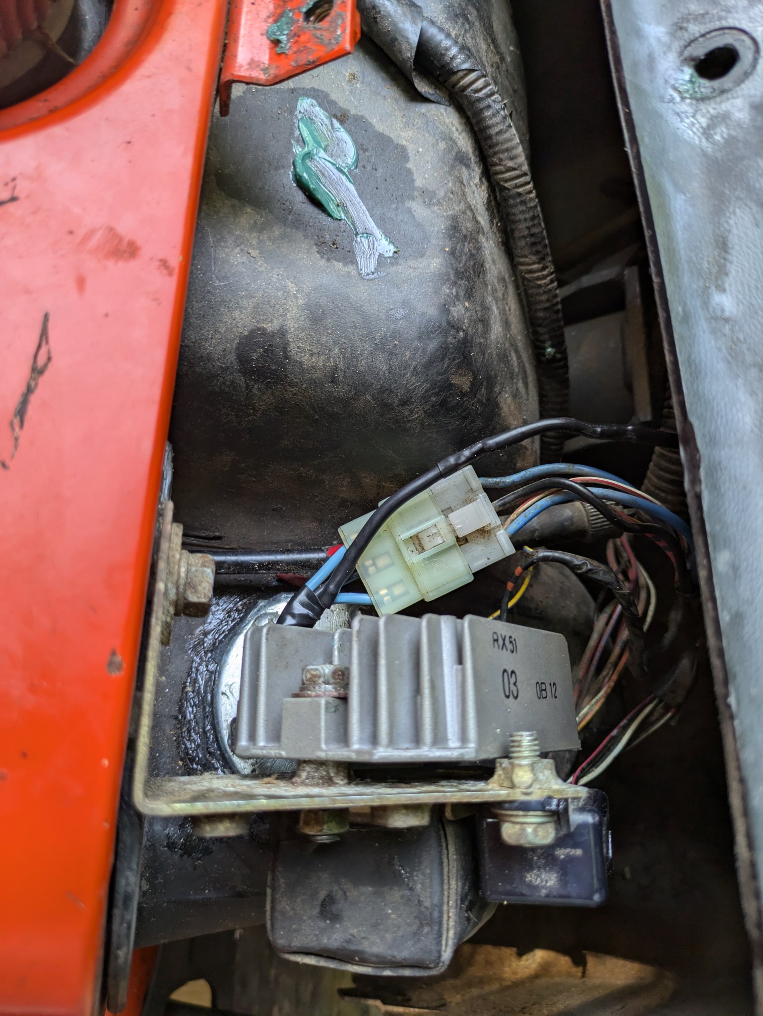

Because the dealer said the regulator was the problem, I purchased and replaced the regulator. But, the light is still on.

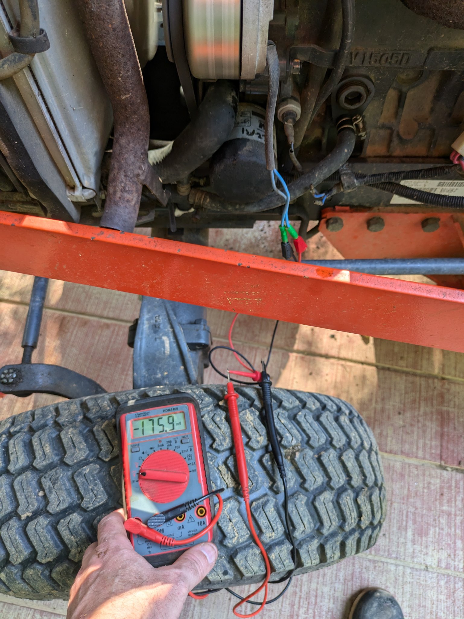

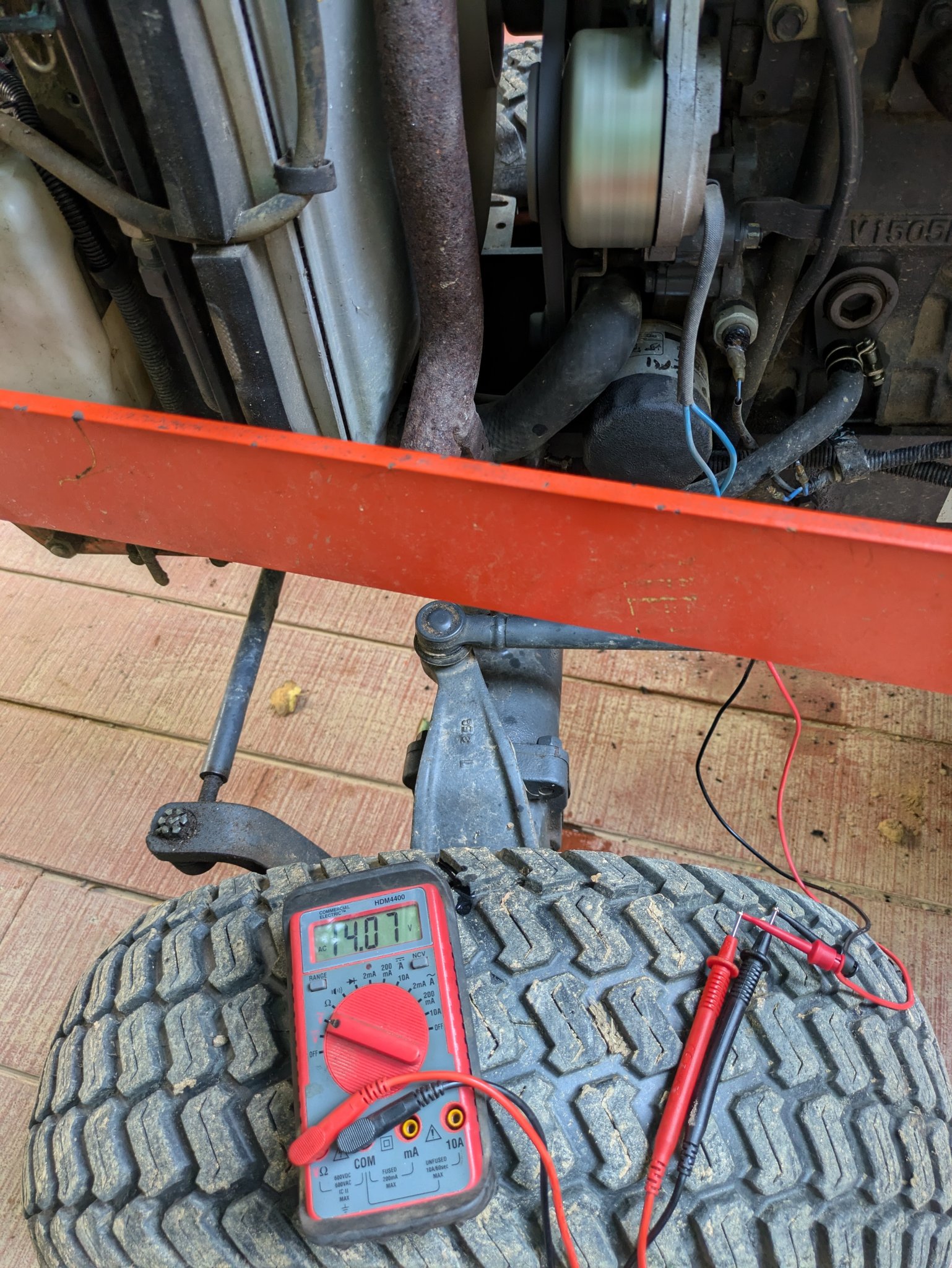

So, I found the page in the WSM for diagnosing the charging system and tested the dynamo with my meter.

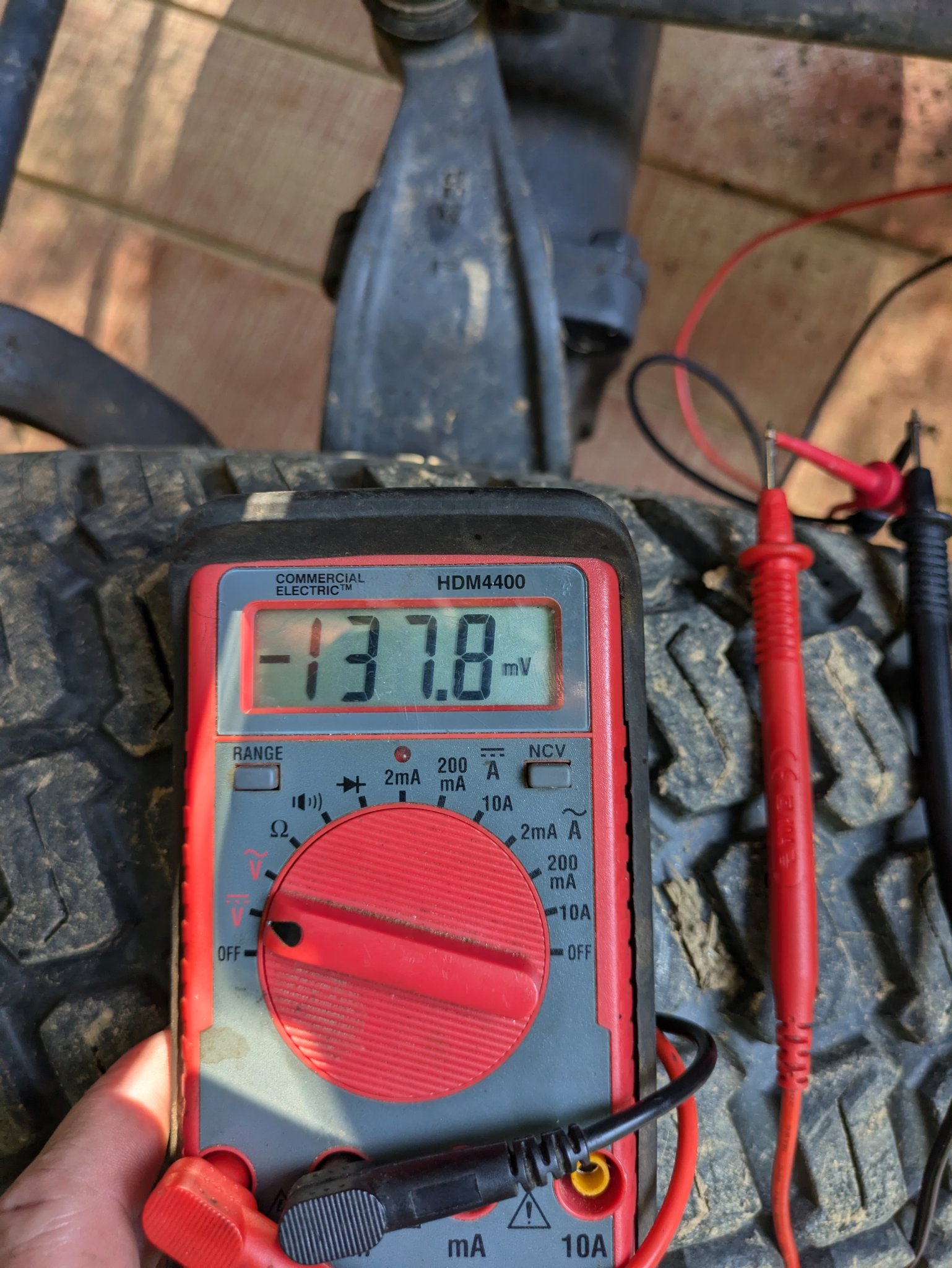

As best I can tell, the appropriate voltage is not being generated. My meter fluctuated in the mV range but did not read the 14-15 volts specified in the WSM.
Before I order another dynamo, can anyone see anything wrong I'm doing here when testing it. It seems very strange to me that something only a few years old would not be good.

I think you have your multimeter on VDC. .
If your tractor has a dynamo, they produce AC, not DC.
Rectifier/regulator converts VAC to VDC.
Trust me, electric stuff is not my strong suit, but I think you need to click the dial one more spot to ~V.

Well don't I feel like the dumb a$$ wasting everyone's time. You are right. What a brain fart. Yep. 14 volts AC so its not the dynamo. It is obvious electric stuff is not my strong suite either! I just replaced the regulator so I would not think that is the cause.

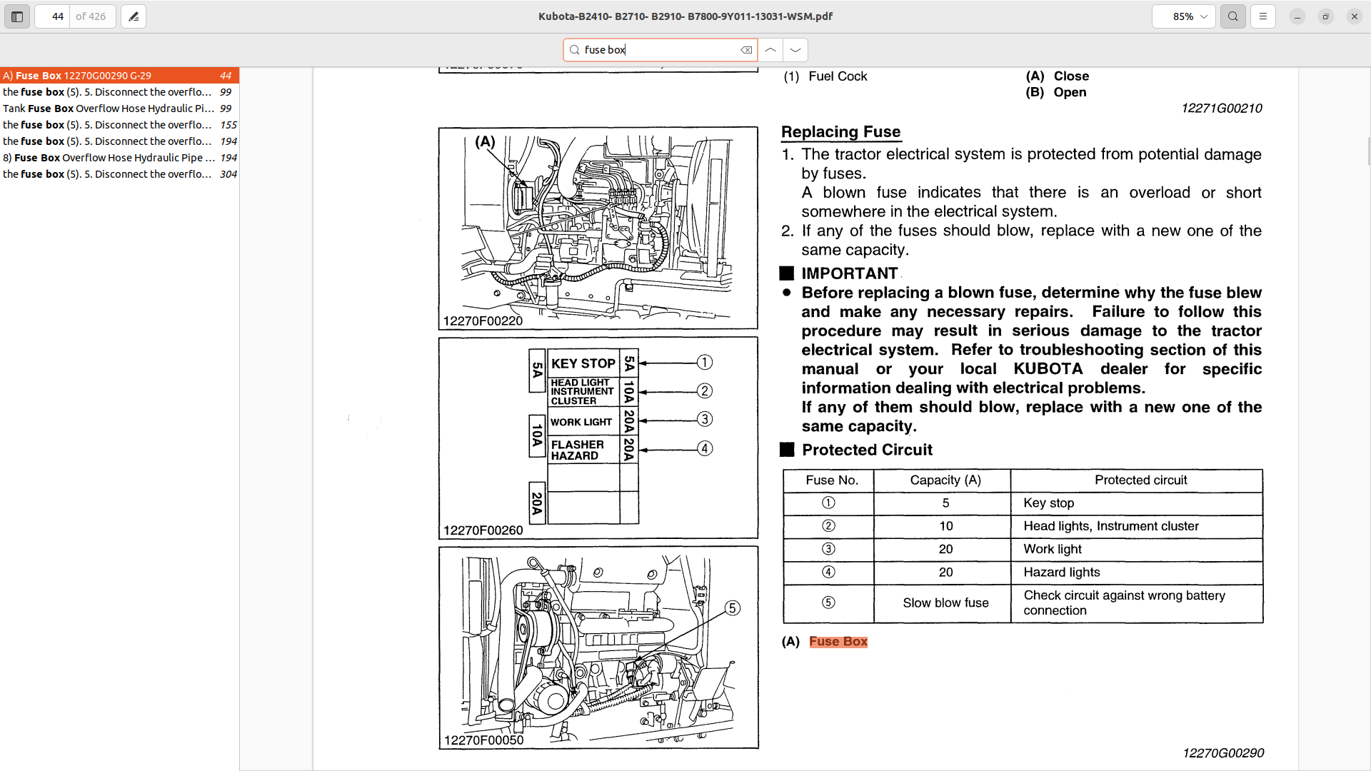

The wiring diagram from the WSM shows a fuse in between. But there is not an obvious fuse in the fuse box for this.
Here is the fuse box label. None of the fuses are blown. It is not obvious which fuse might be the one the charging system goes through. If the head light instrument cluster was blown it would be obvious I would think and I checked the other 10a fuse. It is fine.
I'm pretty stumped. Perhaps there is an inline fuse somewhere? Otherwise, with a functioning dynamo and a new regulator I can't think of a reason the light for the charging system would be on.

Are you getting AC at the regulator plug? DC out of regulator plug? Betting it in the wiring somewhere.
Thanks for the reply Matt. I will check that out next. My fear is the culprit will end up being a wire some GD mouse snacked on.
