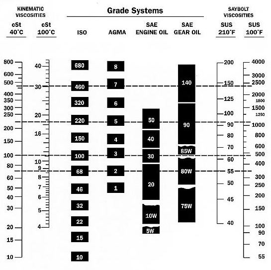

Ralph!!!
SAE gear oil grades are defined at 100C just like engine oil.
Hydraulic oil uses ISO viscosity grading system which is defined at 40C.
Mobilfluid 428
Grade: SAE 10W-30
Density @ 15 C, g/ml, ASTM D4052: 0.866
Kinematic Viscosity @ 40 C, mm2/s, ASTM D445 : 59
Viscosity Index, ASTM D2270: 141
Flash Point, °C, ASTM D92: 243
Pour Point, °C, ASTM D97: -48
9,675
5,099
No. Gear oils are at 104 F.
I have no idea what you think the table you posted demonstrates. The governing specifications are SAE J300 for engine oil and SAE J306 for gear oil. The gear oil viscosity grade requirements table below can be found in the SAE J306 specification. If you doubt the accuracy of that table you can purchase your own copy of the full document straight from the SAE for $44. Or simply ask Google to show you "SAE J306" ......
