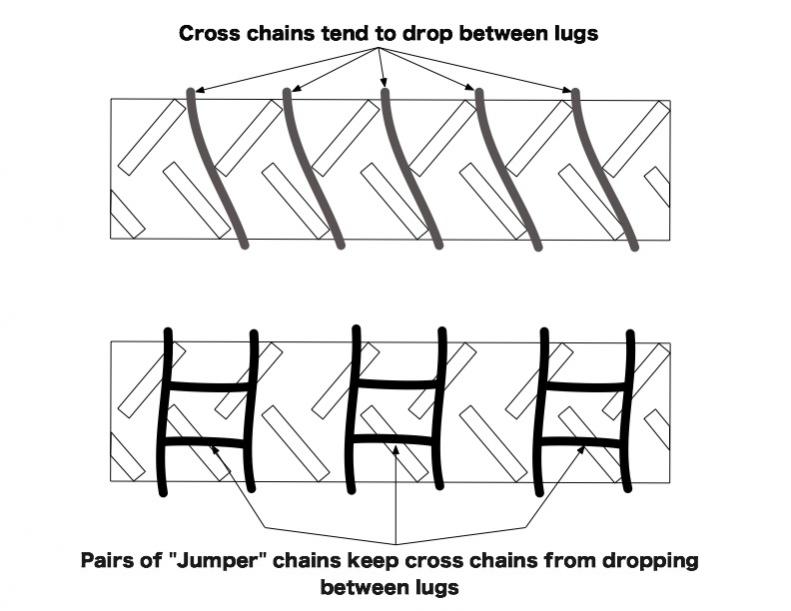

Arizona is the place on the planet to buy tire chains, (at least at estate & garage sales) & I regularly see new or slightly used chains in the $1-$2 per set price range. Apparently everyone who moves here from snow country brings chains with them, and later realizes they will never use them unless they venture up to the high country during one of our somewhat rare snow storms, so they sell 'em cheap. I recently bought (for $2) a set of new, heavy duty, powder-coated, 16" truck chains, that fit my B7100 perfectly, except for the typical problem of the cross chains dropping in between the lugs on my R1s.
I'd like some opinions- Is it worth the effort to cannibalize some cheap chains to add "jumper chains" to a set for my R1s? (as per the drawing) Seems like they'd work well, unless someone already has experience with this and found the opposite to be true. Thanks in advance.

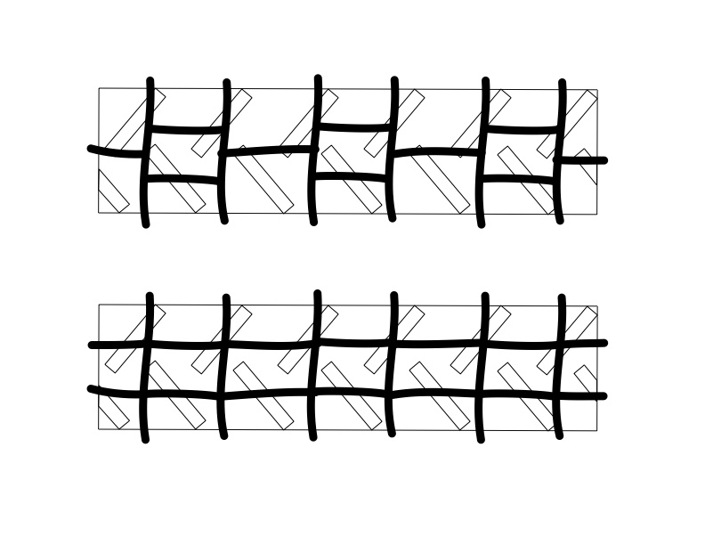

I have a set of truck chains I altered to stop the cross links from dropping into the lugs. I did what you showed in your illustration except I added two connectors so it forms a square in the center of two cross links.

kubotasam- I get it, like this drawing:

Could get even fancier-
I like your very last drawing, It looks like that would work nice.
I was thinking of making a diamond design like these below, smaller scale of course... I have enough scrap chain to build a new set but I may buy some studded chain if I want to go all out :rolleyes:. It's not cheap, but my turf tires would have some grip in the woods...I've searched long and far for options for my tire size but have only found a ladder style. So if I want something special I'll have to build them....
