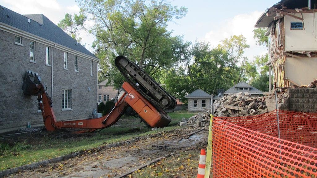

There is no magic number for size, it falls back on the operator when it comes to keeping the shiny side up.
Some guys manage to break and flip stuff , even big stuff.
12,819
5,592
sigh.. bet he drove up onto the 'rubble ramp' to remove the roof ??
agree , 2 units. maybe a small tracked machine is an option ?? without seeing the properties ,it's hard to say what's the right machine but bigger may not be better if size matters
