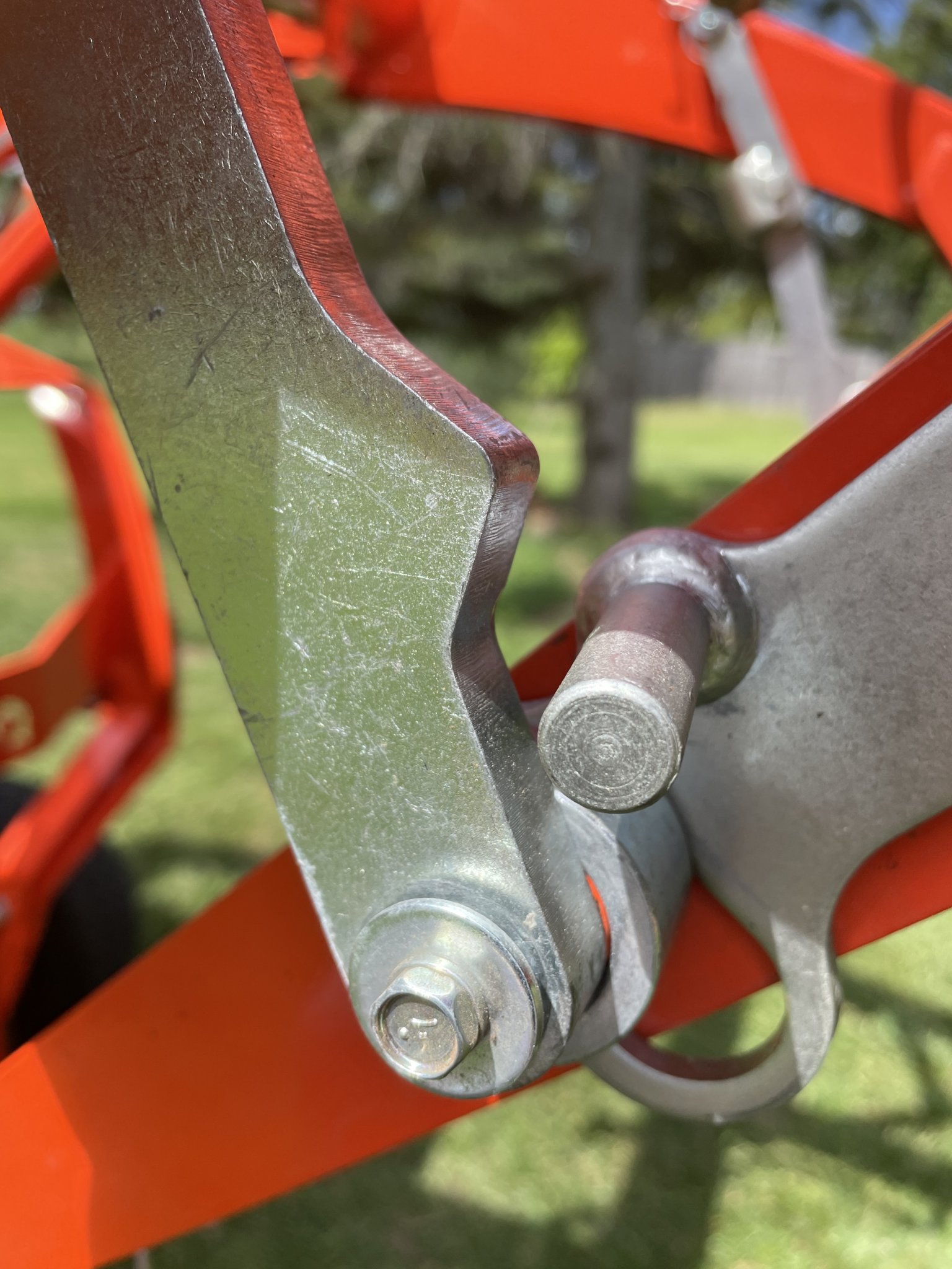

So I am not the only one having this issue!! I have had this problem twice now, where the LH arm did not bend the correct way and it broke the welds on the bump stop which is supposed to be used to push the arm so that pin can contact and make sure it bends the correct way.
I have the bump stops rewelded on and now the LH arm where it contacts the bump stop does not contact correctly and it isn't working properly still. I might need to replace the LH arm for the stand so I can prevent it from happening again and bending the stand.
I will post some pictures when I get the chance, the other thing I am seeing is that if the loader is not taken off correctly (bucket cutting edge taking weight before the stand legs touch ground) that it can cause this. They do say the ground needs to be flat and level to prevent the stand from torqueing, but how perfect does it need? I find it hard to believe that they would have designed it such that you would need a perfectly flat and level ground to be able to take the loader on and off, or if they did then its a bad design. In New England to there is little to no perfectly flat and level ground to do this on especially in residential settings.
