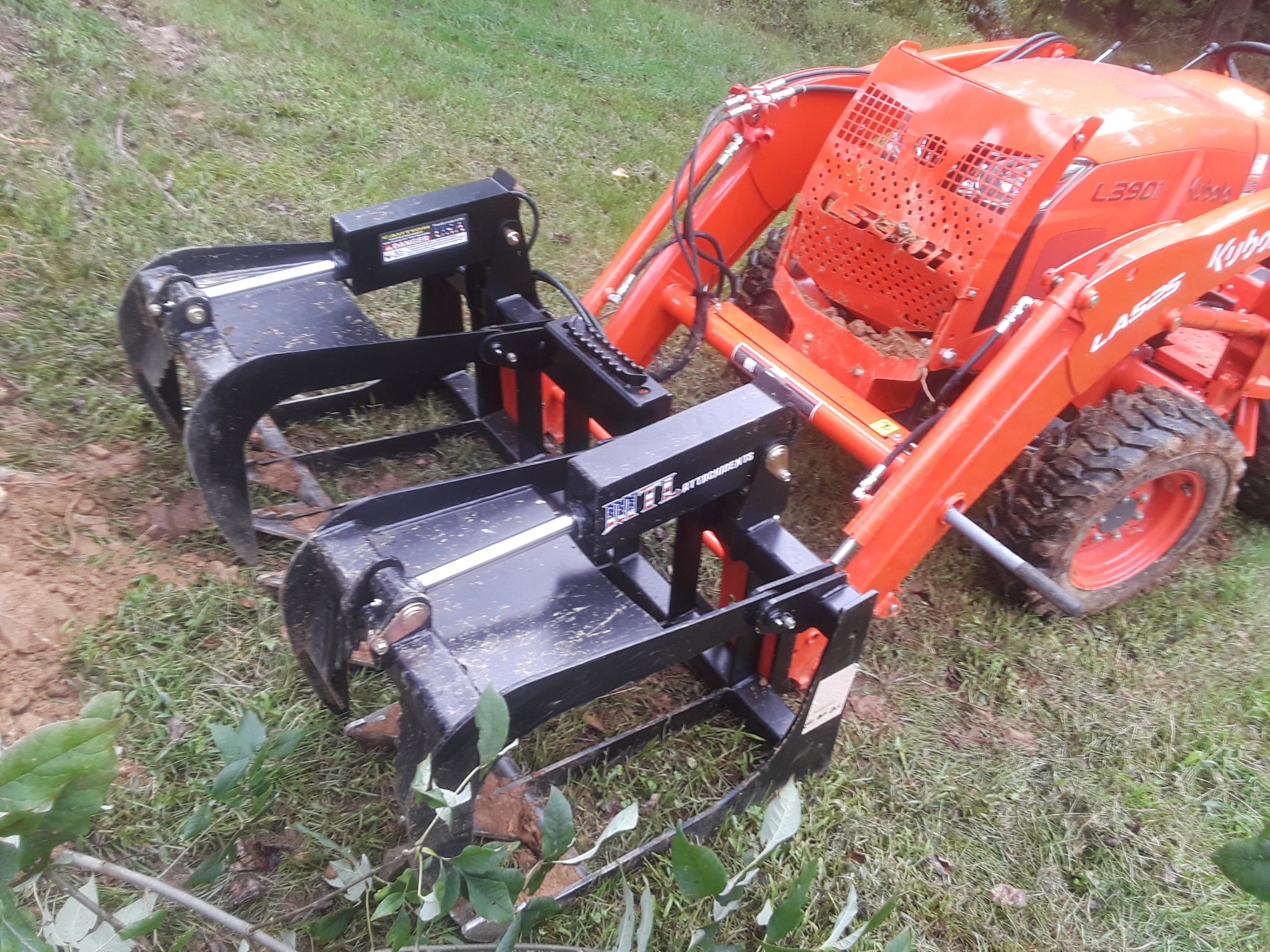

I have the Catawba 55 rake grapple and have been extremely pleased with it. It has taken some abuse and I have had zero issues with it. I cannot compare it to a dual lid version but I would buy it again tomorrow.
