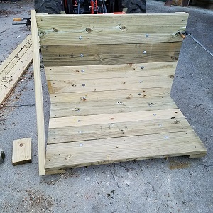

My TSC carryall build so far. Probably over building it, hooking up to QH15 on a L2501. Going to add side 2x4s and chainsaw holder and few other tool holders..I used 1/2in carriage bolts, 1x4in furring strips to give me clearance on the lift pins and toplink. All 2x pressure treated lumber furring strips are also pressure treated. Sucker is getting heavy. I'm liking it so far.
