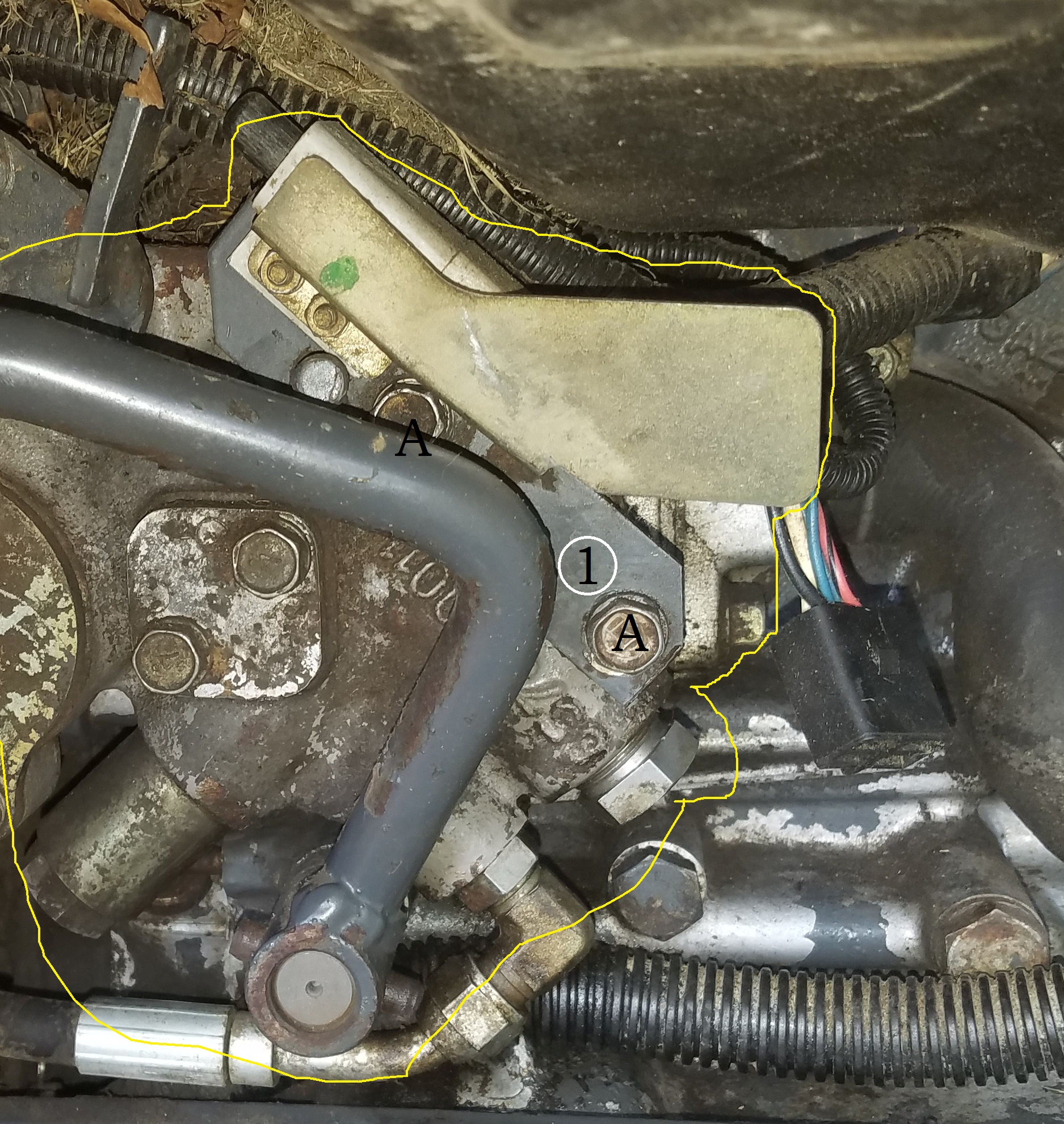

OK - my error was thinking the switches only controlled the fuel solenoid! The PTO clutch lever and range gear shift lever switches turn off the fuel and starter solenoid! I jacked it up removed the wheels and tested both sides of the switches. It is the starter solenoid side of the Safety Switch for PTO Clutch Lever. Now the BIG question. HOW DO YOU GET THAT THING OFF! It says that Part 1 is the Safety Switch Stay but the bolts also hold everything inside the yellow on. But the two little nuts appear to just be on a bolt that can only be accessed by taking off that plate. Do I have to take off the PTO select lever and then remove bolts A? Because you can't get the top left A bolt off with the PTO select lever there. They sure designed this well /s. Lets put the part that fails the most in the worst possible place and hook it on in the worst possible way!
