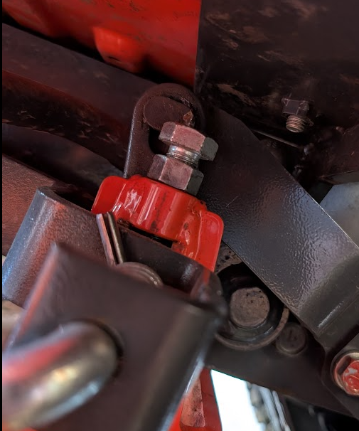

I've got a BX1880 with the 48" MMM. I figured I'd level it going into this season and I just can't get it right. Here's what I did:
  1. Ensured equal tire pressure before starting (14 F/ 17 R).

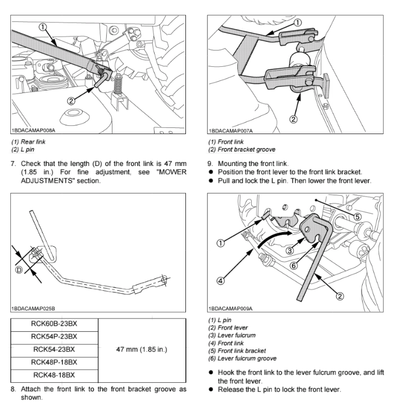

  2. Set front link nut/thread distance to 47mm (measured with a digital caliper).
  3. Checked fender to ground and floor pan to ground on both sides and found them to be equal so the tractor itself is level.
  4. Installed deck and started checking on a flat concrete surface. Measuring based on tips of blades with a John Deere tool.
I have the following issues:

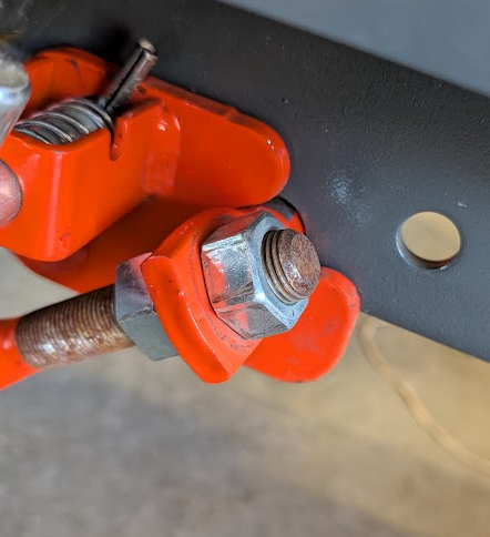

  • I found the front was quite a bit higher than the back. Since the 47mm measurement is theoretically spec, I tightened the side to side adjusters to lift the back to compensate. Found it was still high. Then, loosened up the front links nearly to the max and I'm still about 1/4" higher in the front. This is where both links are set currently:

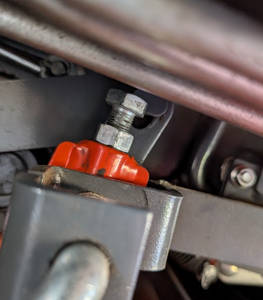

  • Chute side of deck (Right) is also high. I can compensate for this with the bolt adjusters on the sides, but I feel like I'm needing to use a lot of adjustment to do it. Left side of deck is adjusted like this:
    Right side looks like this:
Basically, the back of the deck and left of the deck seem too low and I'm running out of adjustment to compensate for it. I can correct the right/left, but I think even if I maxed out the adjustment on the front link I wouldn't get the front even or lower than the back.
It feels like I have to be missing something! Any ideas? It's a pretty new machine, and like I said the machine itself is level/not twisted. The deck looks perfect, the lift arms don't appear to have a bend or anything either.

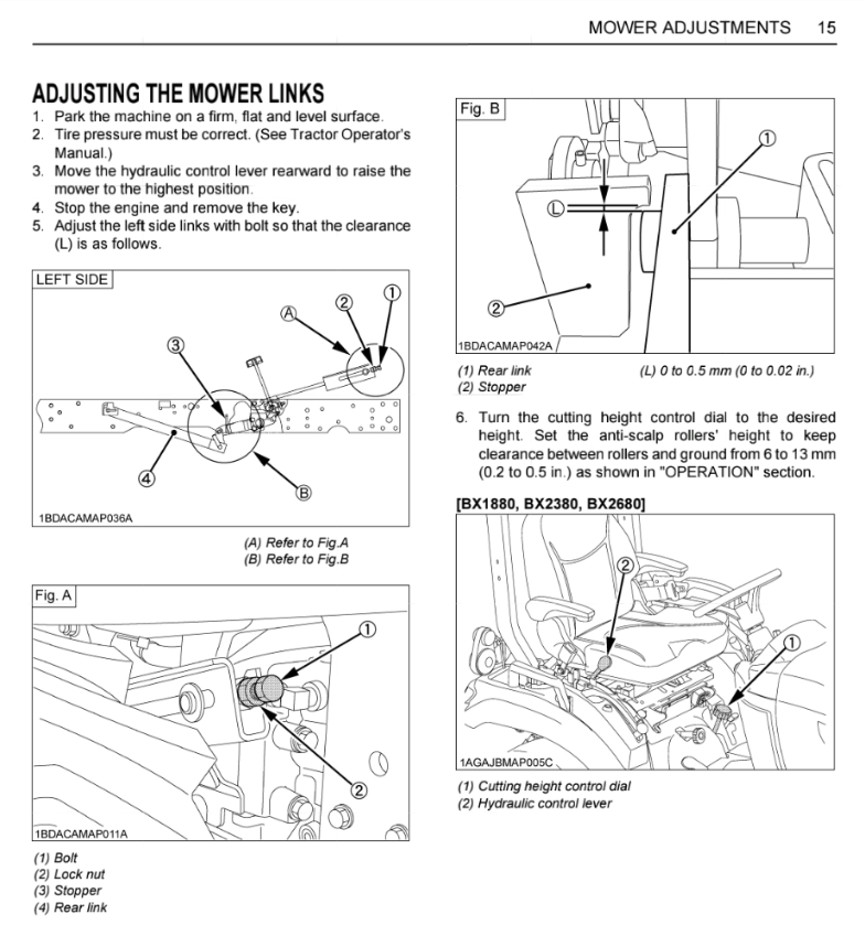

Could this be related to the rear link? I am having a hard time finding the stopper shown in the manual to check adjustment. If I raise the three point, set the dual to TOP, then lower it, it does drop a decent amount. That makes me think there is room for the settings to be higher than they are.

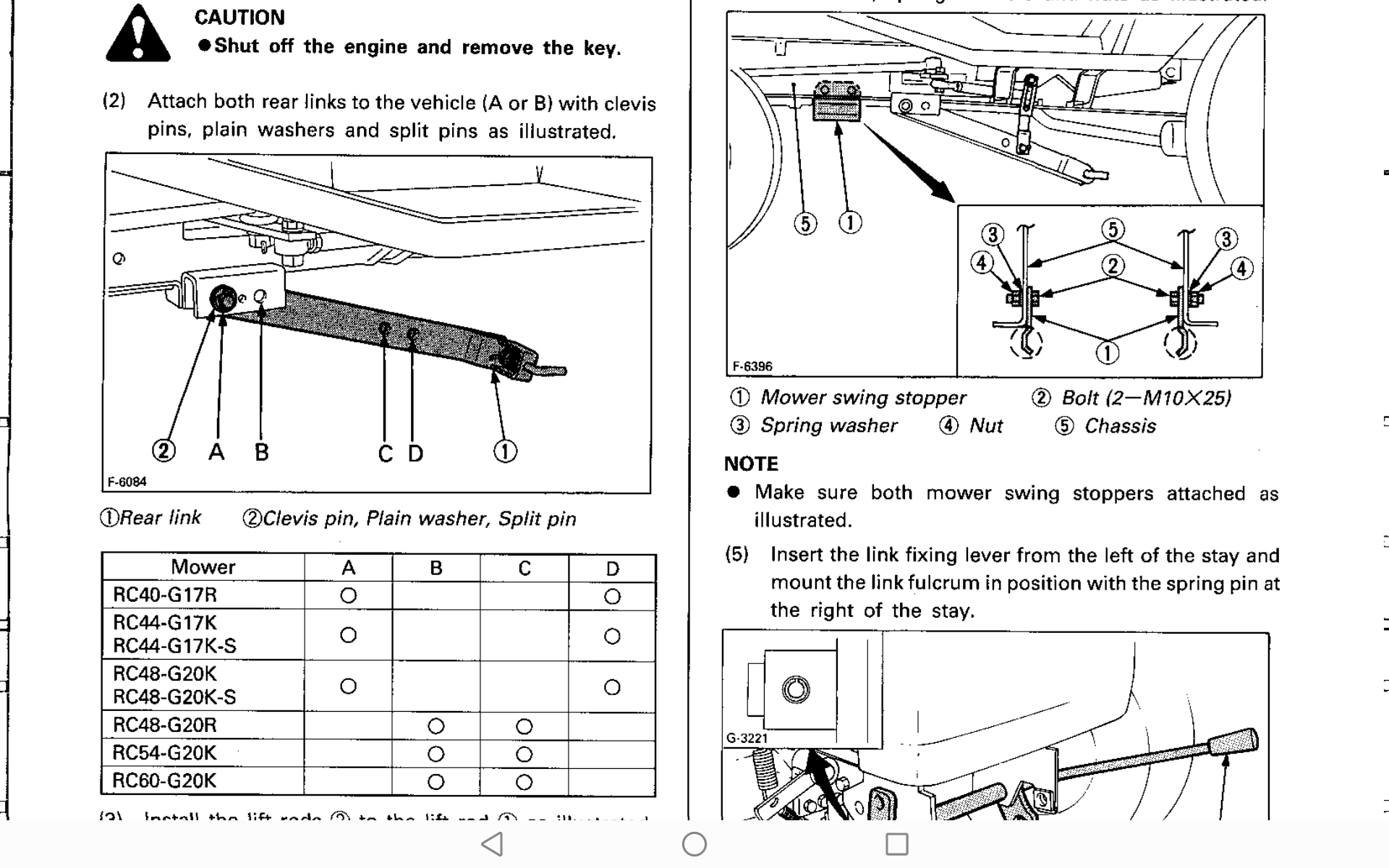

On my tractor the rear linkages can be put into two positions, depending on cutting deck. I cannot see how the linkages run on your pictures.
Also the front linkage on mine was for a different deck / tractor, so there was no way then adjusting it properly.

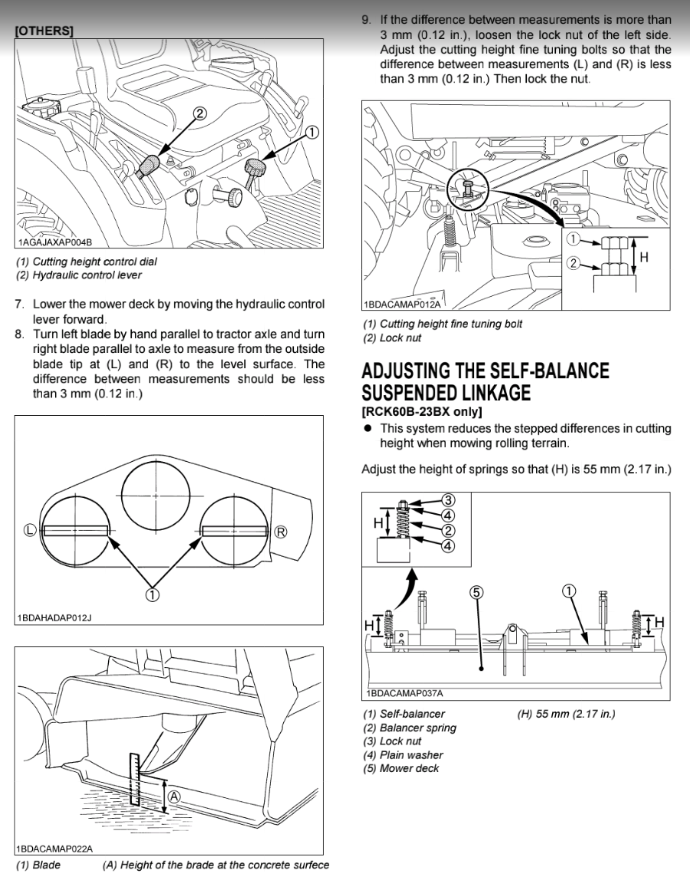

Did you not get an operator manual for the deck? The one for mine describes in detail how to adjust it, they also have the height measured on the outside, so no need to have access to the blades. On my deck the outside frame is not parallel to the blades.
js312
BX1880, LA344S, 48" MMM
Jan 28, 2024
51
32
New England
Oh, I have it. That's where I got the 47mm spec for the front linkage from. It does talk about the front to back level and using the front linkage to adjust it. Problem is, there's no way I can get it in spec - I'll run out of threads. I do see one potential issue. I was using the center blade to check front/back level. It says to use the right one. I expect this is just because the center blade is a bear to reach.
Looking again, I don't think I have different linkage positions like you do - at least I see nothing about it in the manual, and I don't recall seeing holes like that on the arms.
