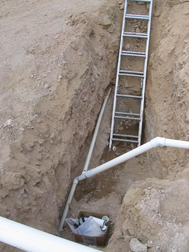

The next day, I showed up with an excavator and started digging slightly offset from the mark. When I had gotten down six feet, I started carefully scraping the wall of the trench on the side toward the survey mark. On about the fifth pass, I exposed the water main. It was exactly six feet under ground and it was about six inches off his mark.
Of course, my wife thought this whole dousing thing was hokum. His rods had fallen off his truck bumper as he left so I gave those to my wife and told her to go find the power line. She found the power line in three attempts in different locations. From that point on, she was a believer.
I took photographs of the well splice down in the trench before covering it. And, I ground a 1/4" slice into the edge of the concrete parking apron as a marker for future use. Those pics are in my well house in a baggie.

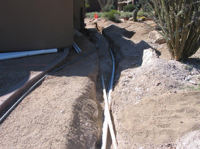

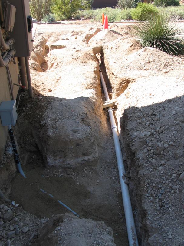

My well line ran right through the power and water line to my barn. The only way to safely dig that trench was to do it by hand by finding the power line and then following it all the way back to the power distribution box. Arizona dirt is largely rocky and I found a hand digger tool was my friend when digging right along side the 220 conduit.
My water line crossing under the 220 service into the house...
My well line goes under the waterline to my barn and runs just above the power line they installed 22 years ago...
