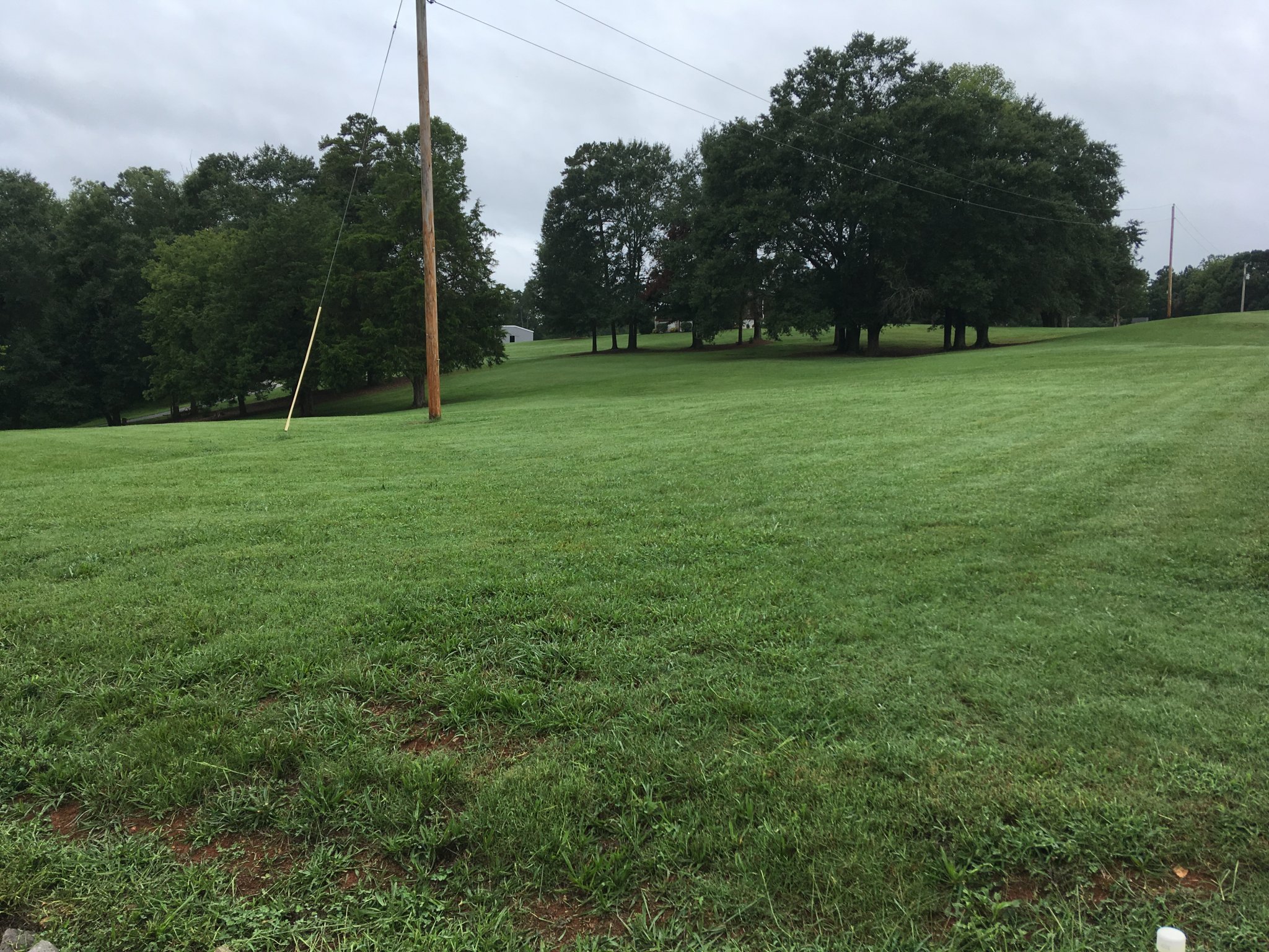

It’ll handle it. But if your lawn is not flat, a six foot mower might not give a good even cut in some places. I cut about five acres a week with mine in the summer with a 60 MMM in med. gear with the go pedal mashed and it takes about 3 1/2 hrs. Comes out nice. EA551AF5-EBD4-4002-896F-13649830514E.jpeg
