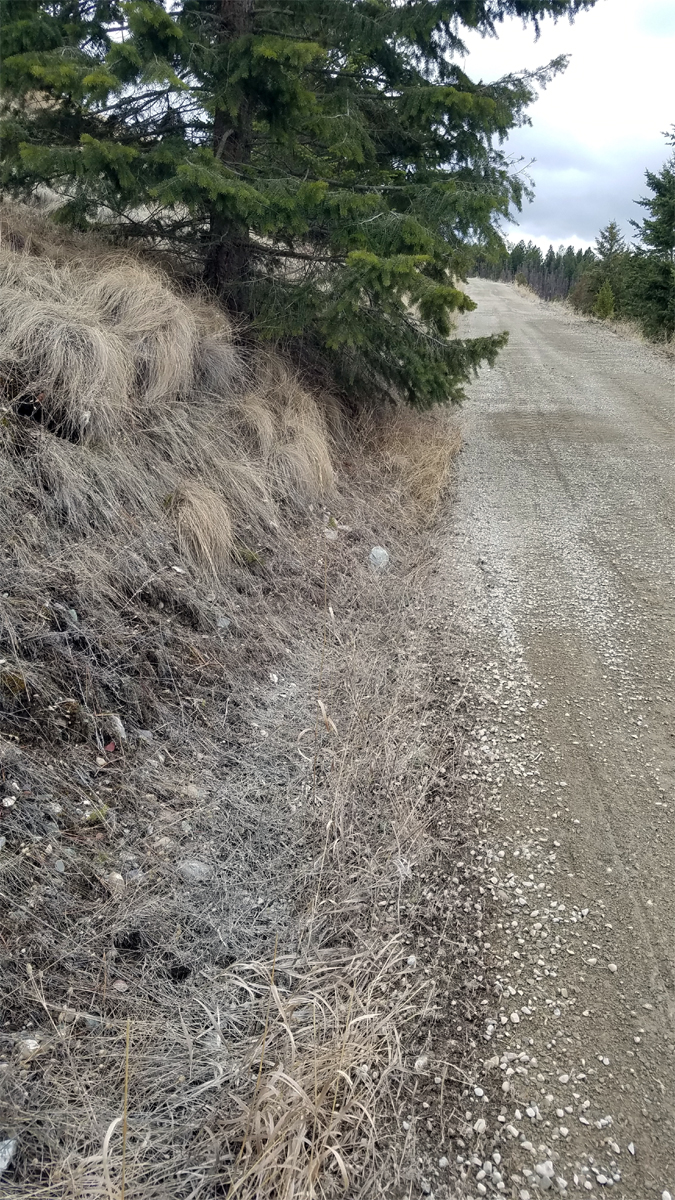

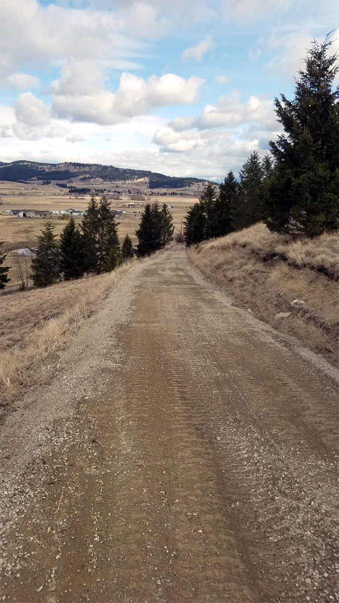

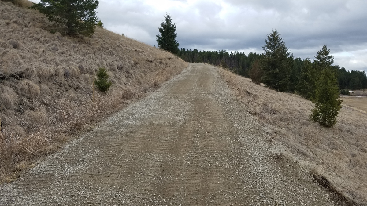

I used the MX and 96" rear blade for about 4 hours yesterday afternoon to fix the 200 yard common driveway that I share with my neighbors who are on 22 acres east of me. I've tried over the past few years to fix it with the BX and 72" rear blade but there doesn't seem to be enough weight to do much of anything. The MX with top-n-tilt was awesome and chews it up without any effort at all. The controls for the top-n-tilt aren't intuitive to me but once I got the hang of angling the rear blade I was really pleased with how much more control I had.
I had used the snow blade on the MX late this last winter to clear snow on the common driveway rather than BX with the snow blower which picked up way too much gravel. The only issue I ran into was lots of partially submerged rocks and bolders along the outer edge of the driveway that would catch on the blade. There were some big rocks/bolders but I was able to remove all over those yesterday so now should be able to push snow off the edge and down the hill with ease.
The problem I'm now facing is drainage. About five years ago my previous neighbor and I split the cost ($3,500) of having a road contractor come out and fix the driveway which was in a terrible state and they did a very good job. They dug a ditch at the bottom of the bank the length of the driveway and installed a culvert under the driveway at the bottom of the hill to take water away, and it worked well. Last year however, my neighbors snow removal contractor decided to dump truck loads of pit run on the driveway without consulting me or my neighbor. That crap had huge 3" to 4" rocks in it and a very heavy rain event a few days later resulted in a load of gravel washing off the driveway, into the ditch and ultimately into the culvert which became blocked. Needless to say I wasn't happy about that and spent a couple of hours trying to unblock the culvert. My new neighbors are from CA and are the passive types so wouldn't confront the contractor over this issue but offered to pay for anything that I had to do to fix the issue. The ditch is still obstructed, the culvert is still partially blocked but the driveway sure is looking nice.
I plan to have a couple of trucks of 3/4" crush delivered but want to fix the drainage issue first. So now to my question. How do I fix it? I don't want to spend weeks out there with a pick and shovel, so do I have an implement that will work? I was thinking about swinging the back hoe bucket off to the side slightly and driving down the hill with the BX but in a "duh" moment realized that the bucket wouldn't be aligned with the ditch. So what to do? Should I try to straddle the ditch with the BX which would require cutting some bank away, make a nice trench and drop a french drain pipe in there, cover it with 3" minus and hope for the best?
Any help would be much appreciated ... and I can't say enough about the MX and how well it handled grading the driveway. The photos below are looking up and down the driveway, and the photo of the ditch shows the only section that isn't totally full of rocks and gravel.

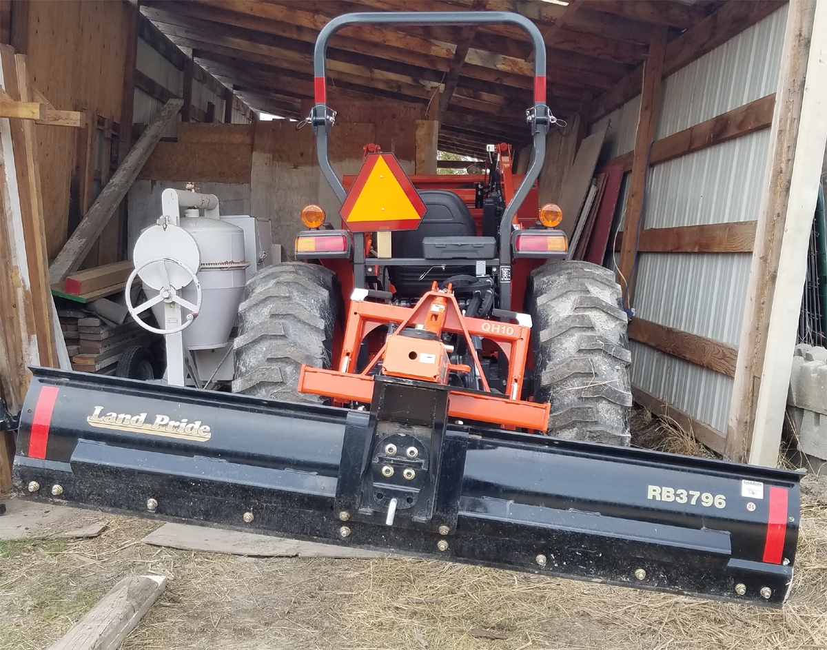

So back to the driveway. I tilted the rear blade as far as it'll go in the direction I'd want and you can see the angle in reference to the top of the ROPS. This is with the left lift arm set by the dealer as shown.

After looking at your pictures you are in luck! Look at the very back of your blade and their is an adjustment to tilt your blade. It will also offset 26" according to the Land Pride brochure. Examine the booklet you should have gotten with the blade to see the adjustments that it will let you do.
You should be good to go with that blade as a lot of blades are not as adjustable as that one.

BigG, I hadn't realized that the blade had that extra adjustment at the back... well spotted! I was surprised that it has two pins for horizonal adjustment. One standard pin to rotate the blade in the horizontal plane for blade angle, and another that allows the entire blade to swing left or right (translate) in the horizontal plane relative to the three point. I'll pull that third back pin this afternoon to get more of an angle and see if I can drag the blade down the hill to open up the ditch.
