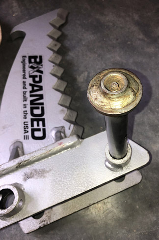

I bought a Bxpanded Backhoe thumb for my b2601 and used it for about 8 hours over a two-week period to make a rock wall. My machine had 180 hours on it. After an hour, being initially impressed with the thumb, I ordered a few additional parts including a quick connect and a ripper. At the end of the 1st week after around 8 hours of use, I noticed the implement was getting sloppy. The steel drilled out in the metal to adjust the jaw started to get misshapen and the holes became egg-shaped. I moved the adjustment to another hole same thing occurred.
I then called Bxpanded and talked to technical support and sent them a video of the problem their engineer told me that they had never had this happen. So he agreed to send me another one as a replacement. In the meantime my new parts arrived for my machine I went to install them and discovered the long bucket pin sent out with the Bxpanded Backhoe Thumb was bent and caused the wear sleeves in the Backhoe to break at @188.4 hours on the machine!
I had to hire a machinist to come out and remove the bent pin and press in new sleeves in the machine. I was told the pin and steel manufactured by Bexpanded are too weak for my machine!
The machine was laid up for a few days and I took the backhoe off as it was unusable. Finally, 2 months later the new Thumb and parts showed up I installed all the equipment. I immediately noticed that the new parts were very loose the actual bar for the thumb had almost ¼ inch of play. The holes drilled for the pin on the shaft were way too big for the included pin. I tried using the parts and after about an hour of carefully using the machine, the holes started getting egg-shaped again! I called the company again and took another video and pictures of the problems. I again sent the pictures and videos to Bxpanded Engineering dept.
After numerous calls and no response, I called my credit card company and stopped payment on the second order. After approximately a month I received a call from Ryan ‘the owner’------. He asked me to send out detailed photos and measurements of the product I also sent out a video. After numerous conversations and emails spanning months! He agreed that there was definitely an issue with the product. (Phone records and dated emails are attached).

He finally determined that I was shipped out the wrong product TWO TIMES. I found it very Strange that the parts fit on my machine!

I also brought the Thumb to Mid Cape Steel and I was told the steel was not strong enough for the application.

You're not the only one who has issues with their quality. The knuckleheads couldn't even weld a pin ear on the my tooth properly. I had to take it to a machine shop and have them ream it out so the pin would fit....

Although you should not have to repair new equipment, I have a relatively simple suggestion/solution if it's "within your wheelhouse."
Sounds to me like the "hammering effect" of the pin, onto the relatively small surface area of the pin hole is at least part, or possibly most of the problem.
I would make/buy a pin one or 2 sizes larger than the original.
Then buy/make some 1/2 thick "Boss's" with an I.D. the same diameter as your "new pins" OD. (2 for each hole.)
Ream/drill the old holes to the "new proper" size.
Now use the "new pin" to align the Boss's to the holes, and weld them in place one at a time.
In my head, with that extra surface area the"new Boss's" provide, you would be good to go.

If the 'adjustable steel tubing sections' are only 1/8" thick walls , I can see why they're being destroyed. I'd expect them to be a minimum of 3/16" thick walled, though 1/4" would be better. I agree that 'bosses' could /should be welded on and a better( higher ) quality pin be used.
Sadly the company has lived up to it's name and 'EXpanded' the holes !!! Someone 'engineered' the product without properly researching the forces involved and selecting the correct materials for the application. Since others sell 'thumbs', makes me wonder why this company didn't 'check out the competition' before making theirs.

Yes one of my solutions was to buy a bolt then grind it down to get rid of the slop in the holes. Then thought about welding heavy duty metal around the square tube and reinforced metal plate. Never welded anything up. Doing the bolt part helped quite a bit but then the long grease able pin bent the one shipped out by Bxpanded bends this is week metal also. Then of course the back hoe was screwed up. The sleeves broke and new ones had to be pressed in. Talked with the owner about this also...

It would appear that BXpanded uses low quality (not AR400) steel.
BXpanded is likely only acquainted with building light duty thumbs/rippers, for small/lightly used machines.
I have an aftermarket thumb, and an aftermarket ripper on my L48 TLB, both built by different aftermarket fabricators ( ME, and GA)
These accessories added to my machine seem to be indestructible, but they did each cost 3+ times what BXpanded charges.

I have a b2601 at 25 horsepower it is apparent to me that the fit and strength of the steel are inadequate for this machine. So again why sell it? You are probably correct they are used to people buying stuff and actually not using it. It's too bad but they initially seemed like nice people but I was hosed...

Don't use it. I was at the Kubota dealer last week buying another set of wear shims (sleeves) and pin from the crappy mild steel pin screwing up my backhoe.
I had left it in since I could not find my old pin.
Another big mistake!
I figured I would just gingerly use it..
I brought in the pin that came with the ripper and they took one look at it and laughed.
Lesson learned.
New hardened steel pin around 40 dollars.
I figured out that if a huge company like Kubota is not making a ripper,quick connect for the machine there must be a reason.
Yes, maybe it will work for a few hours and maybe a few days. But when it starts getting sloppy it ruins your backhoe.
Like someone else said tons of videos of people just buying this stuff and not actually using it.
Really expensive mistake at this point.
