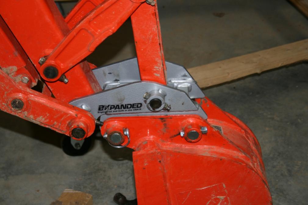

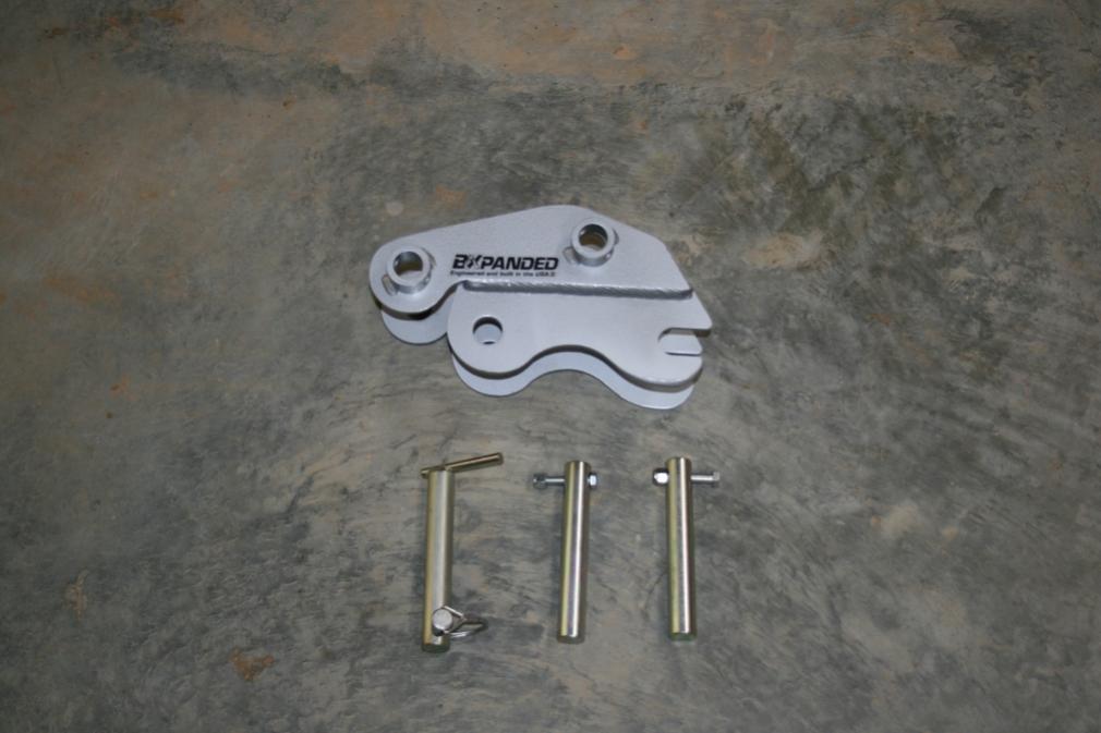

I received my Quick-On Connector Saturday, 14-Jul-18.
I ordered two permanent pins and one quick change pin.
After I took the 3PT arms off and connected theBH77 to the tractor, my wife came out and helped me remove the 16" bucket that was on the backhoe and install the Quick-On connector. You could do this by yourself, but getting the connector, mechanical thumb bracket lined up with the dipper arm would have been a lot harder.
After getting the Quick-On Connector installed, I put one of the permanent pins in my 10" bucket and when I put the quick change pin in, the handle on the pin would hit the bucket.
This made it so the keeper pin wouldn't go through the hole in the bushing and the hole in the pin.
I sent an email to BXpanded about this and got a reply from them:
BXpanded said:
When Kubota welds the bushing on that has the hole in it they don't always turn it the same way. We looked at many of the factory buckets and came up with an "average" to position the handle on the pin that typically works but occasionally it does hit since they put them on turned somewhat randomly from bucket to bucket. We can swap it for you with one that has a shorter handle or you can cut the handle off some to make it easier to deal with. Let me know which you'd like to do.
So I cut 1/4" off the handle and was able to put the keeper pin in.
I'm very happy with the Quick-On Connector, all the welds look good and the fit is great. Can't believe Kubota doesn't offer this themselves.
I would recommend the Quick-On Connector to anyone that has more then one bucket. I think it is well worth the money.
