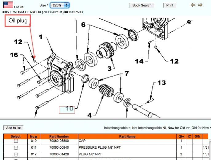

Hello everyone, I got my snow blower mounted and working on my BX2200. It was tough AND expensive since my machine had no loader valve. My operators manual explains what to lube but not how. It says the gearbox oil level should be checked every month and 80W90 oil added if needed. I don't see a plug.

On the front of the gearbox. Part # 12 in the pict.

Thanks for the reply. The worm gearbox on my machine differs from the one in your diagram. Mine has a breather plug on top with a spring loaded cap. When I look in I can see the worm gear. Now my question is "how full should it be" Do I cover the worm gear with oil? Thanks again

The vent-fill plug is on the top. It still should have a level plug on the front of the box. Mine has a recessed hex drive plug about 1/2 way up the front. Take a pict of the front of your gear box and post it here.
