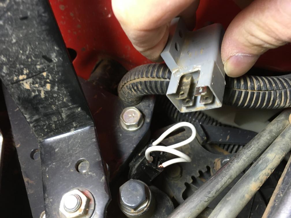

I believe I found the culprit. The HST safety switch. I removed and bypassed all safety switches one at a time, and tested each with a multi meter set on ohms. I can "zero out" all except the HST switch. I started the tractor normally when I had it bypassed. Unfortunately it is Sunday so I have to wait until tomorrow to call the dealer. I tried to fine the switch online with no luck. I cannot find anything that looks like a part number even with a magnifying glass, other that a stamped in 1ll. Is this a Kubota Dealer part only?
