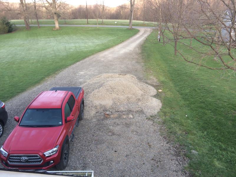

My driveway is approx 200' long gravel with a slight grade up hill from my garage to the road. Widest point is around 30' near my garage. It narrows toward the road to about 12' wide.
I was considering pushing uphill out the driveway and stack across the road.
I can also stack to the sides in my yard.
We typically get a fair amount of lake effect snow where I live. Something around 100".
Appreciate any other advise you guys have for my specific situation.
Here is a picture of my driveway and my new (to me) rig!

I have no experience with a plow, but I believe they can be a struggle with more than 8" of snow especially when it is heavy snow. At least for price comparison I would look at a used rear snowblower. A front mount snowblower is a lot nicer, but a lot more expensive and harder to find used (at least one that will fit). You have a relatively short and straight driveway so a rear mount blower would work and not require an hour of backing up.
