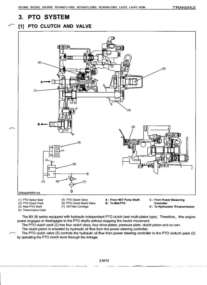

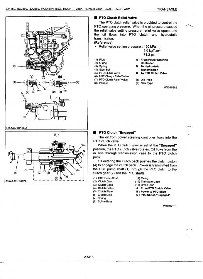

I copied two pages from my shop manual.
Thanks those diagrams are good, this says it is for the BX18 and 23 but I assume that it is similar to the BX25. This means that the PTO clutch pressure release valve would be on the left side if looking toward the back of the tractor. I wonder if it could have some sort of debris or blockage that prevents it from fully shutting which would sap off some of the hydraulic pressure going to the PTO. Does this sound reasonable? Either way, at my next opportunity, I will try taking it apart and see.
