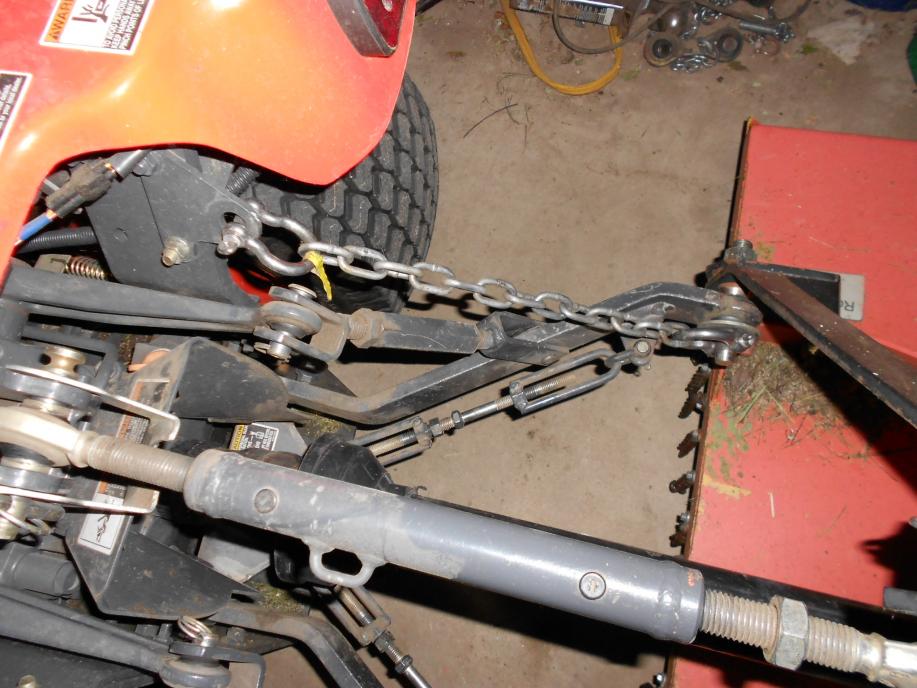

I have enclosed a pdf of the page from my BX 2360 where the setup is shown for putting the 3 point hitch arms in a static positon while using the mower deck.
I hope page is big enough to see. Had to compress it to be within file size limits.
Note on diagram the you disconnect the lift rods #2 and #7 from the lift arms and connect them to the Holder plates # 9 as shown in the bottom diagram.
Hope this is helpful.
