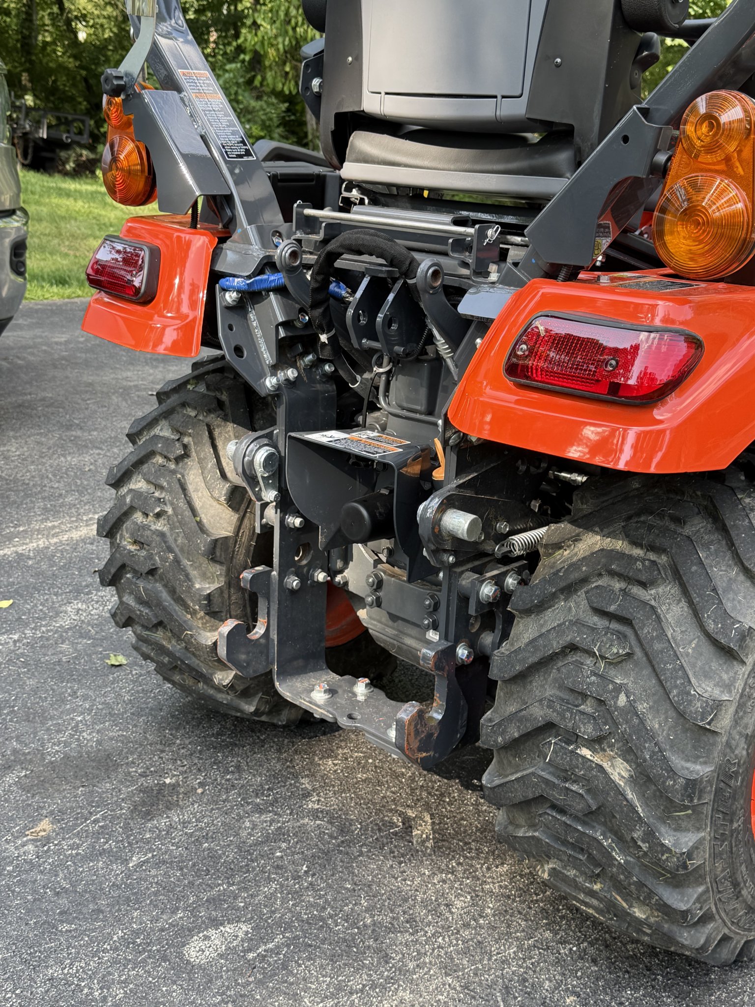

Does anyone know if I can take a GCK 60–23BX grass catcher unit and mount it on my 2021 Kabota BX 23S - 3 point hitch, or use the existing backhoe bracket to mount the material collection system?
I found a very lightly used 2008 GCK 60–23BX locally and would like to use it on my tractor if I can.
what modifications if any, would I need to make?

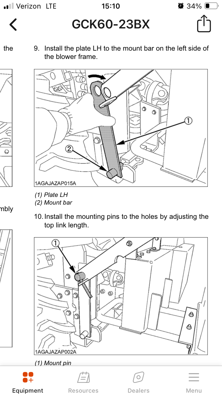

On my BX1870, I had to install two support stays for my GCK 60–23BX…these stay on the BX1870, I do not know if that is compatible with the BX23S. There isn’t a lot if room back there.
