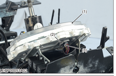

By adding your relay, you accomplished nothing more than making the original failing relay feed an unnecessary one.
The original relay is under the top part of the dash on its RH side.

Thanks - I suspect you are right. Do you think the voltage drop that I am seeing is from the worn/dirty/corroded relay contacts on the original relay. I see 3 relays in your picture. Is one of these the culprit?

Thank you for the feedback. I am starting to be convinced it is a corroded relay or ground. I have checked all the safety switches. They have continuity and the voltage on them is right at 12V. As soon as it dries out a bit here in Louisville, I plan to look at the starter relay installed by Kubota. Sounds like it is behind the dashboard. I originally thought it was one of the relays near the fuse box.

Issue resolved. The relay behind the dash had a broken wire. I fixed this and the tractor started. Thank you to all that replied. I learned quite a bit about the electrical on this tractor.
