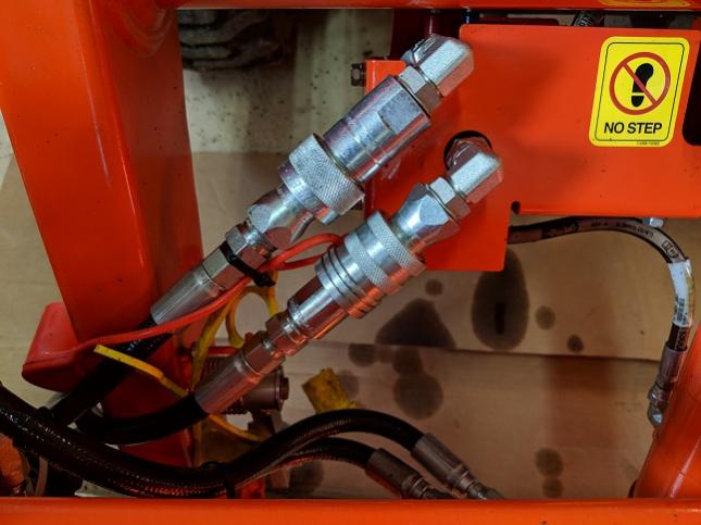

Redbusdriver
BX23S MMM PHD Grapple
Apr 13, 2017
85
Vancouver WA
Kubota calls the BX diverter valve a 3rd function kit, hince the naming confusion. We are all right!
If your dealer charges you for dust caps, go to Amazon, plenty to choose from.
The bucket curl down is left, I chose that for grapple close as it made sense to me. I asked the same question a while back, same answer, do whatever makes sense to you. Once you decide which way you like the control to work grab some zip ties and mark one set of connectors so you will hook up the same way each time.
FYI, I had my dealer install flat face connectors at first to match the loader and backhoe connectors. Had a devil of a time hooking up the grapple, trapped pressure made one connection impossible to work. I switched to pioneer couplers and have had no problems hooking up.

Go to Tractor Supply or similar place and buy some valve connector covers.
I like how you have the 90 degree on your connections. Mine stick straight out, and while it helps put the connections on, I am just waiting for something to snag on them and rip them off, or bend them. May have to look into doing what you did! :)
