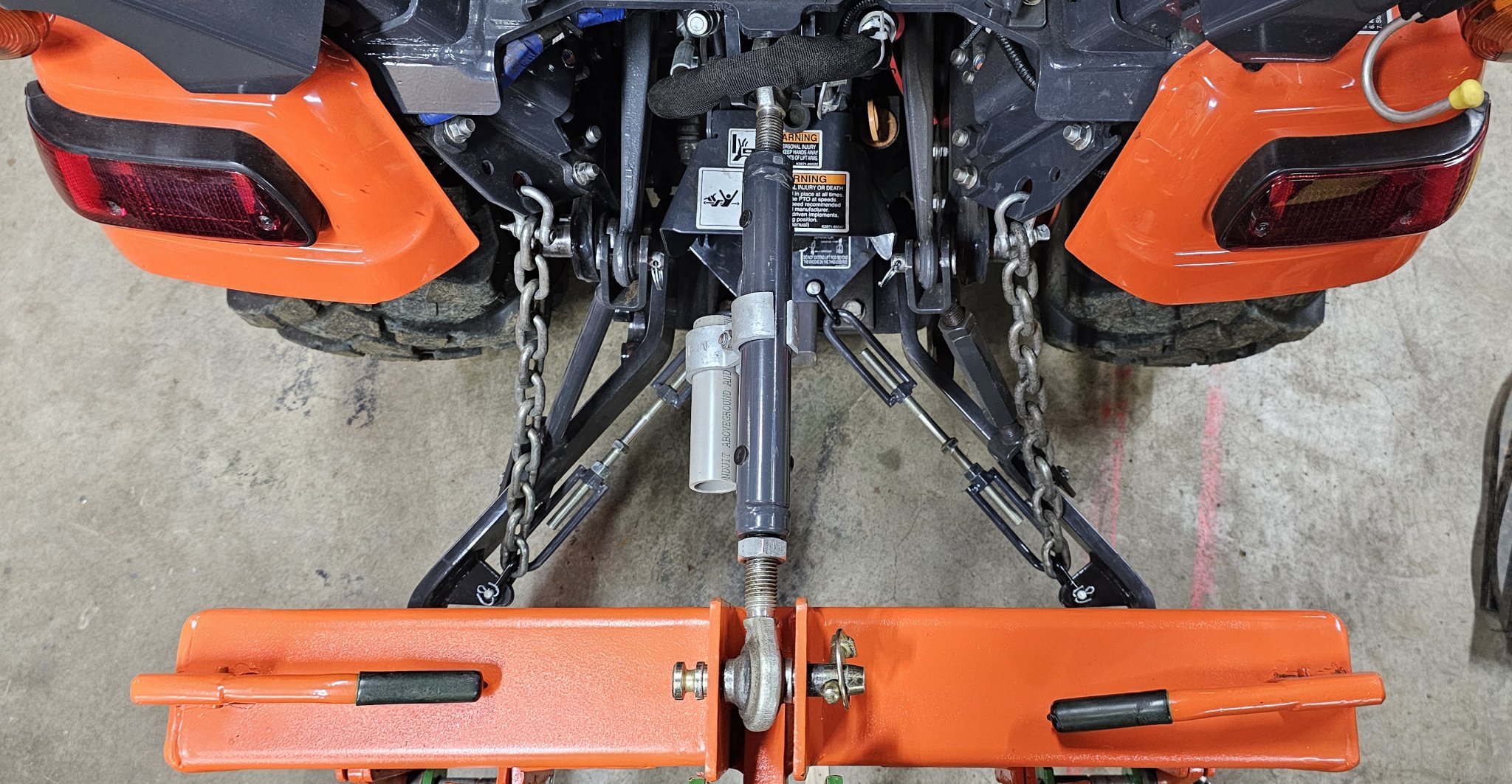

Connect chains to the very most bottom of the ROP. Heavy turnbuckles in that chain-length would be a plus.

Here's how I did it on my BX23S.

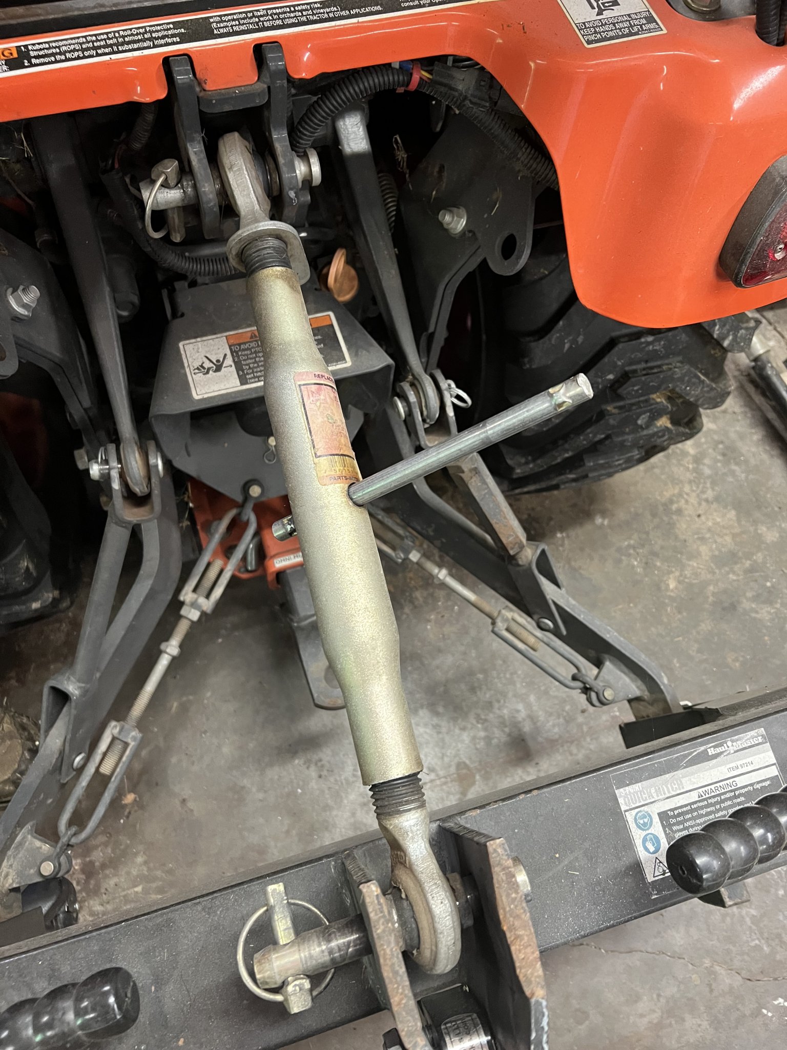

A distraction, but I was disenchanted with the Kubota OEM top link from Day 1.
Have a couple aftermarket TL's of different lengths. $25 at the time - - much easier for me to manipulate.
I don't necessarily care for the toplink myself. I considered drilling through the center and putting the thru-rod in it, that's when I did what I did as seen above.
