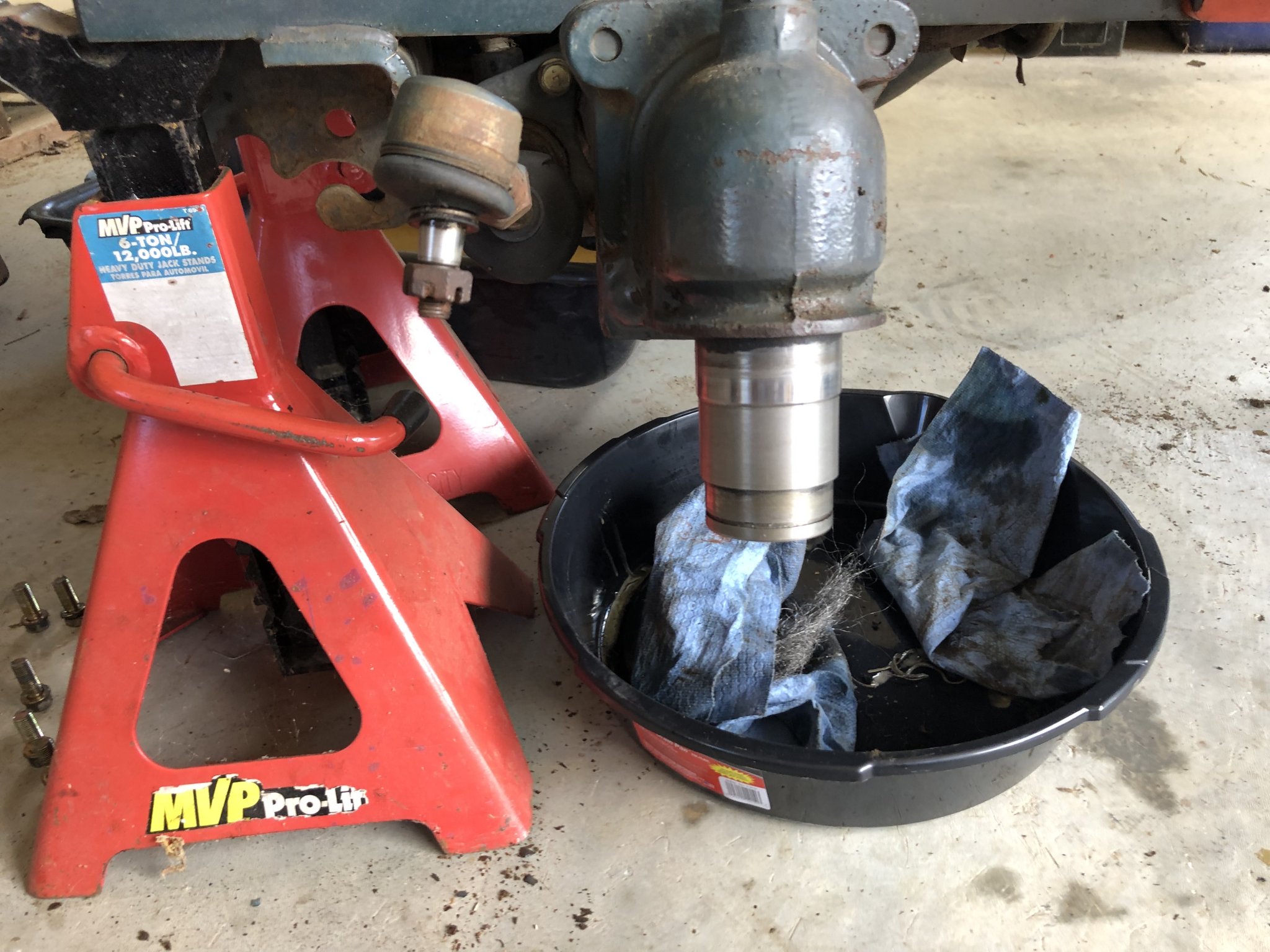

Once you get the Knuckle free be VERY careful . I had a glob of grass/dirt that fell into the knuckle when I dropped it down off the housing. ( I refer to the housing as the part that stays on the tractor. The part that the Snap ring goes on. )

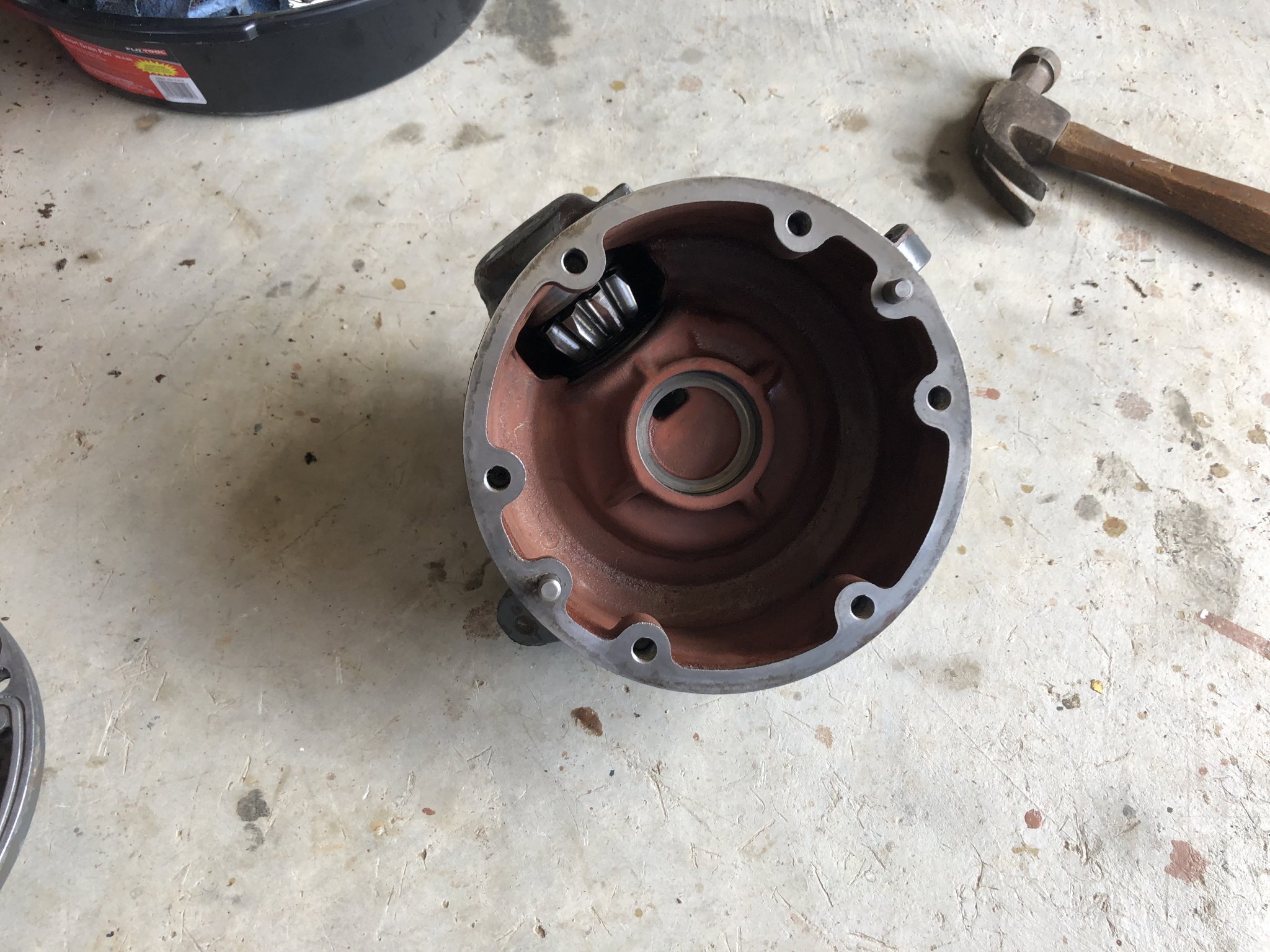

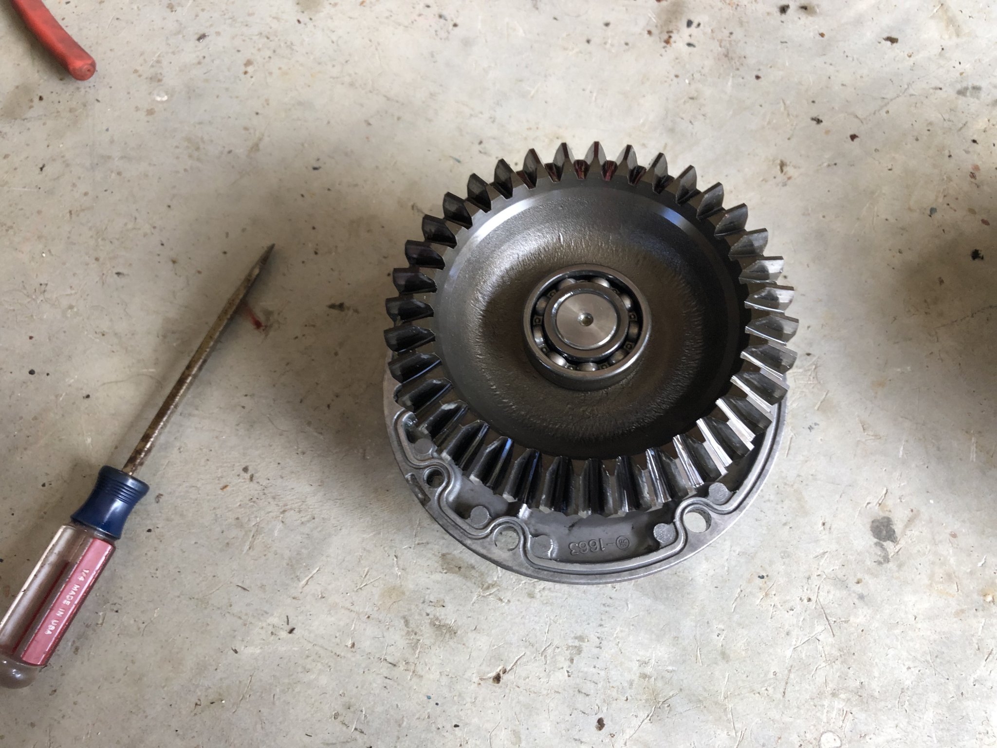

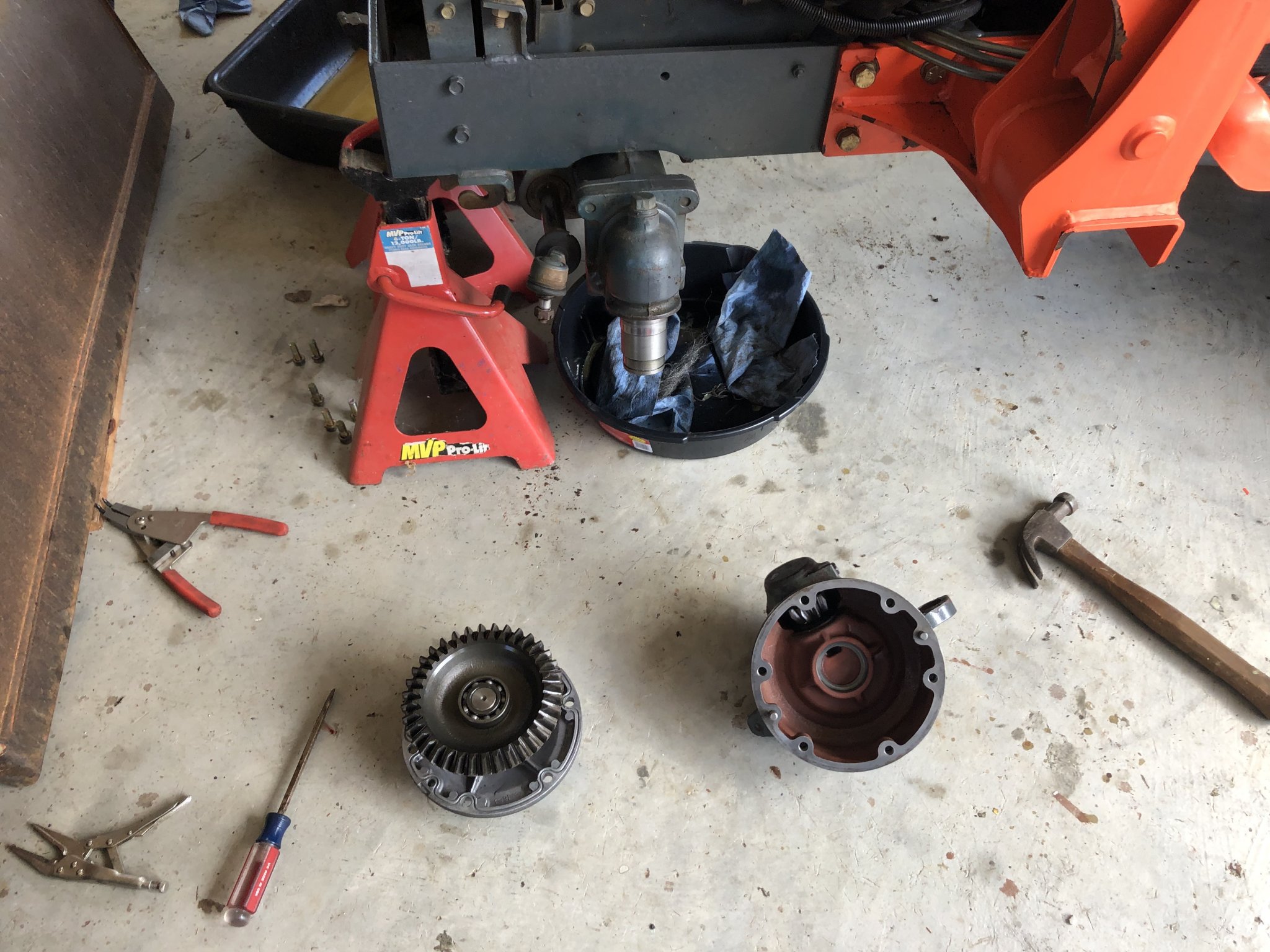

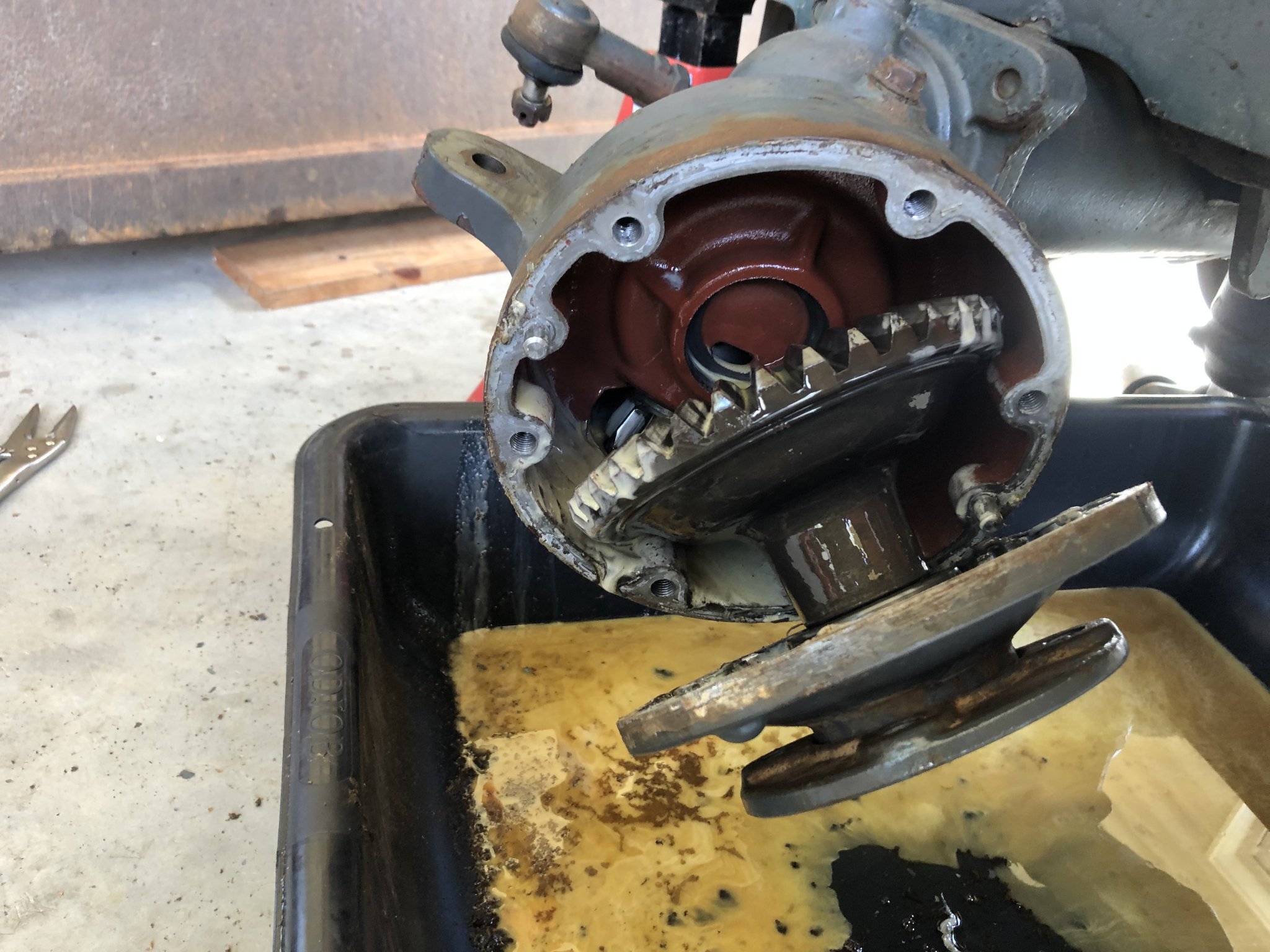

7. there is only one way to get the Gear Cover out of the Knuckle.
Study the picture close. It only goes in and comes out this way.
Other wise, the gear catches the bolt holes.
You have to tilt it and then slide it out.
Picture for parts clarification
Housing
Knuckle (Right) and Gear Cover w/Gear (Left)
