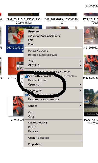

There are online sites to resize them. Just Google "Online image resizer."
There is also a Windows add-on the can do it. It puts an option in the right-click context menu to resize images.
