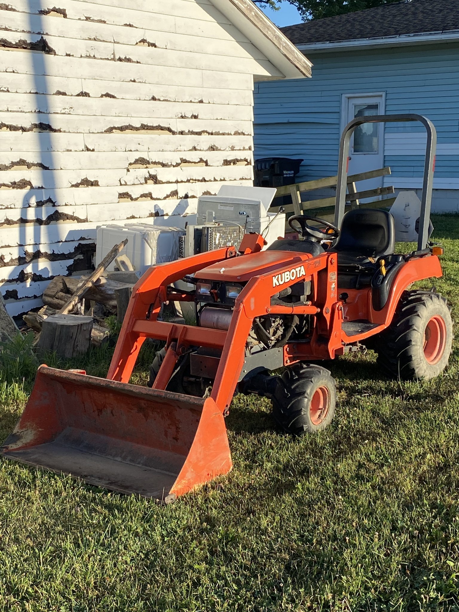

Hi all. Just got a used BX2200. Works great, but like all used stuff I have a couple items to address with it. I’ve done quite a bit of automotive work/repair but this is my first tractor.
1. Sometime when I turn the key to start it, it just clicks. I can hear the glow plug cycle. The starter on it is new and if I jump the starter with a wire it turns over and starts immediately. If this was a vehicle I would say the starter relay/solenoid was bad. Does my tractor have one and if so where is it located? If not, any idea on what could be causing this?
2. Been using it quite a bit the last few days. When I went to start it yesterday it turned over slower than normal. Sounded like a low battery. I don’t know the battery age etc. Am I correct in assuming there is an alternator of some kind that charges the battery while running? I am going to put the battery on a charger and see how it does, but I want to make sure the starting system is good. I will be using it in the winter to plow snow and I know from my diesel van that it is important to have the starting system in good shape when it’s cold out.
