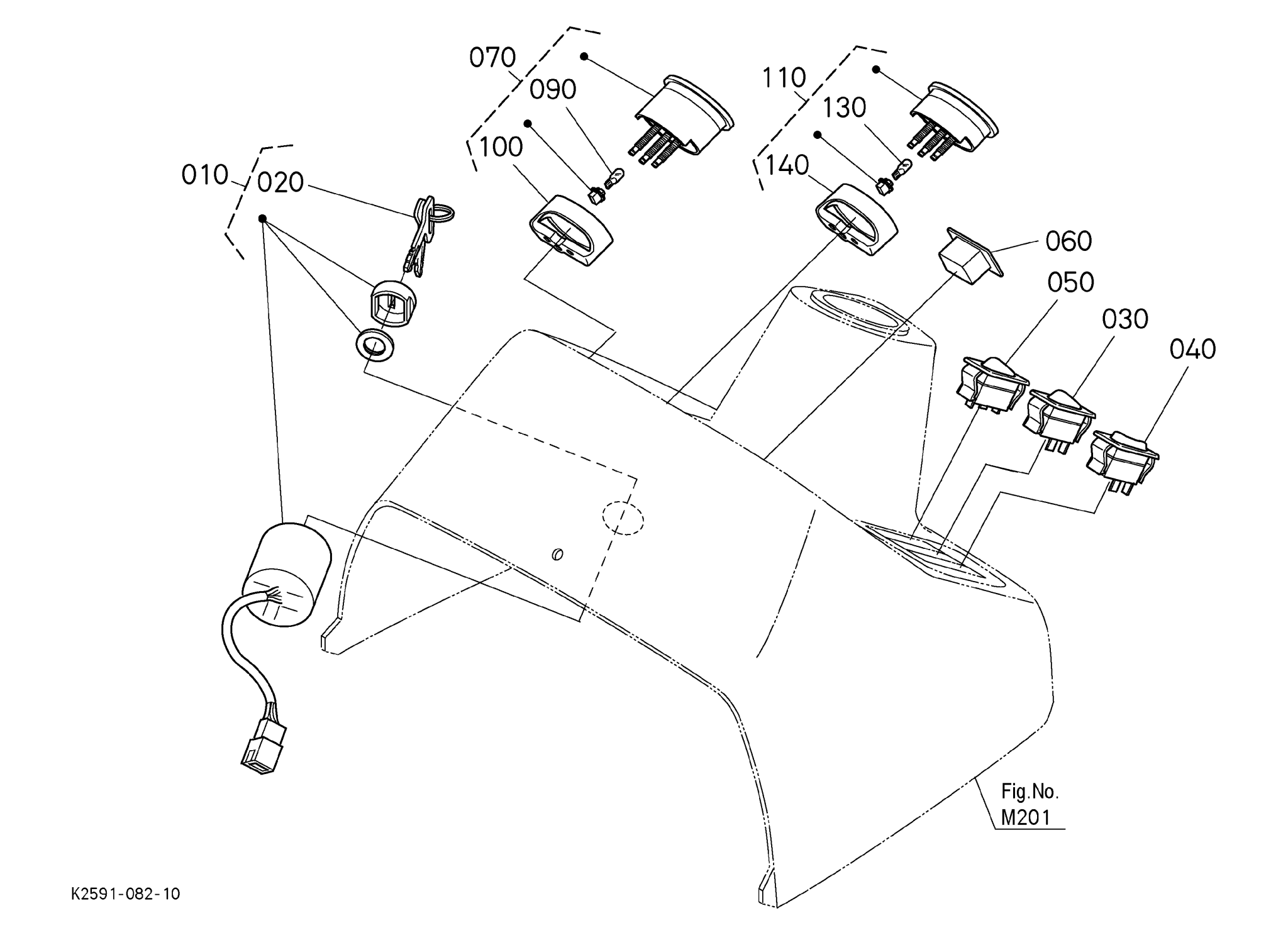

this is for the BX22D, gauges look 'old skool' to me, remove the wires, undo 2 nuts, retainer comes off, meter pulls out ?

I think you need to post a picture of your dash get a proper answer.
There are individual gauges in the post #4 but you are describing a dash panel to me.

Does the clear plastic sheet that covers the gauges pry off? Is there double sided tape keeping it on so the gauges will come out the front?
From GreensvilleJays picture in post #4 it looks as if the wires have to be removed at the back (three threaded studs), then the bezel #100 comes off the back and then the meter is pulled out the front.
I see a small hole on the front of the instrument panel. It could be that this is for a bolt that holds the panel is place; the panel is probably hooked in on the other side somewhere. So you can try to take the bolt out and try to remove the panel for easier instrument access.
