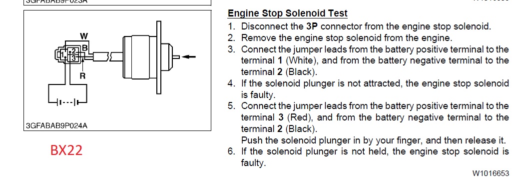

My post last night was based on the assumption that since the stop solenoid on the BX22 was the same one as the B21 the wiring and logic would be the same.
THIS was a wrong assumption
Below is the test procedure from a BX22 WSM
Dave
5,929
3,140
Dave
Boy, that procedure sure looks exactly like the one in the workshop manual for my BX2200!
But in my case I saw no lever to manually shut off the fuel, but maybe I missed it, do not know.
Anyway, let me state what the resistance of the two coils of the replacement solenoid were. The solenoid has been working fine since installation a few months ago.
I measured 21.5 ohms between black and red wires. And 0.48 ohms between white and black wires. I did not deduct the slight amount of resistance in the leads. The VOM was a descent Fluke 8060A.
I do not wish to confuse the issue, and as I said the BX22 may be different than my BX2200, although both were sold at the same time. Just adding this as it may be useful.
Important thing is that the low resistance coil in the solenoid will pull high amps if connected across the battery directly. Calculates out as being greater than 20 amps. If this coil were hooked into the hold circuit side, it would blow the fuse every time (but not the 30 amp fuse).
Since the White-Black wires are defined in the WS procedure as the pull-in circuit, I would confirm those wires going into the solenoid have lower resistance than the Red-Black wires, which are connected to the hold circuit coil.
OR just follow the WS manual procedure and see what happens. If things work backwards, it would indicate the replacement solenoid is wired backwards internally. This would be the easiest thing to do I guess.

Well it turns out I actually have a printed copy of the BX22 WSM. Was given to me by a coworker who bought a BX22 years ago. And looking at it the electrical circuit for the BX22 is exactly like what is on my BX2200.
At this point, I need to go back and see exactly what the OP is saying his problem is. But what I posted above regarding my tractor, should apple equally to the BX22.
I tried to find the other thread where specific details regarding this exact problem was discussed. I failed. Would like to blame the site search feature, but it is probably my lack of ability in searching.
Pages 6-M2 and 6-M3 in the BX22 WSM show the electrical schematic.

Ok, sorry for the delay, I wasn't able to get back to my garage until this morning. Thank you all for the help and the link to the diagnosis book, very helpful.
Still not working but I understand the problem better. Part of my issue is that I confirmed the old oem solenoid doesn't work... the resistance across both white and red is 0.6 ohms. The resistance across the new aftermarket is 32 ohm for the red and .7 for the white. I believe I have been ch a sing my tail using the old solenoid which is the cause of blowing 20amp fuse. When I replace the fuse, I get 12v with key on for red wire at solenoid.
I followed the diagnosis of the new aftermarket solenoid and it operates appropriately, retracting when power applied to the white and staying retracted after I push it with power to red. I also verified my ignition switch is working appropriately.
What I found, however is this: when I plug the new aftermarket solenoid into the 3p connector but remove from the engine, and turn ON, I push the rod and it holds. I turn switch off and it extends appropriately. When I turn to START the rod retracts appropriately, however when I turn to ON the rod stays extended, but if I push it in, it holds...its getting power.
I have 2 theories: there is a blip in power going from start to on where the solenoid extends and cuts fuel, obviously this isn't the intent. This could be caused either from defective ignition switch (again i confirmed but perhaps there's some slack between the settings where the circuit isn't closed) or the aftermarket solenoid isn't great and can't tolerate this momentary blip.
I plan to buy a new ignition switch and oem solenoid.
Also, I did find the 30amp fuse and it passed continuity.
Thank you all for the help, would appreciate any feedback on my diagnosis.

When the solenoid on my BX2200 failed I had essentially the same resistance readings as you do. Low resistance on both coils.
You said: "When I turn to START the rod retracts appropriately, however when I turn to ON the rod stays extended, but if I push it in, it holds...its getting power."
When you go to the start position, the rod should retract and stay retracted when the switch is returned to the ON position. What you are describing seems to be correct operation (Your wording is a bit confusing). The rod does not retract until the switch is turned to the start position. The hold coil only holds the rod in after the pull in coil pulls the rod in.
I would suggest you try the solenoid with it hanging in the air (you may have already done this, but I am not certain), and start the tractor, and see what the rod does. It should pull in when the engine turns over and stay pulled in when the switch is returned to the ON position. (The tractor just needs to turn over, not start, as the pull in coil is energized through the starter solenoid circuit).
If it seems to work like this, I would delay buying the OEM solenoid.
Like you say, the ignition switch could be de energizing the hold coil when you move it from start position to ON position. You will know more if you watch the solenoid operate when you start the tractor with the solenoid hanging if the air.
You could run a temporary jumper from the 12 volts somewhere to the red wire of the solenoid, and see if the solenoid rod stays retracted when you start the tractor and return the switch to the ON position, if it does not work properly when you try it using the ignition switch. If the rod stays retracted when you start the tractor with the jumper in place, your problem is not the run/stop solenoid.
From your description, it certainly sounds like it may be an ignition switch problem. Couple more tests as mentioned can likely isolate the problem and save you the $100 plus that an OEM solenoid costs (and which from your description you probably do not need).

Success!
OEM solenoid did the trick and I'm back & running. My final diagnosis (with lots of help from all of you):
Original OEM solenoid failed and blew 20amp fuse. Aftermarket solenoid did not function properly, combined with using original solenoid to diagnose & repeatedly blowing 20amp fuses confounded diagnosis.
Replacing with new OEM solenoid & fuse solved the problem. Good lesson to use OEM parts! I did replace my ignition switch with new aftermarket in the process, and I'll keep it installed but hold onto the old one. For $30, seemed worthwhile to have a spare on hand... the new switch also feels a bit "tighter" than the older one.
