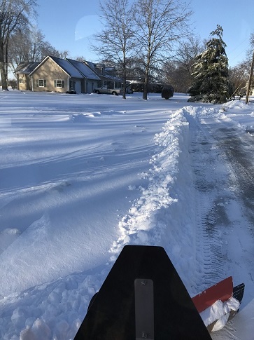

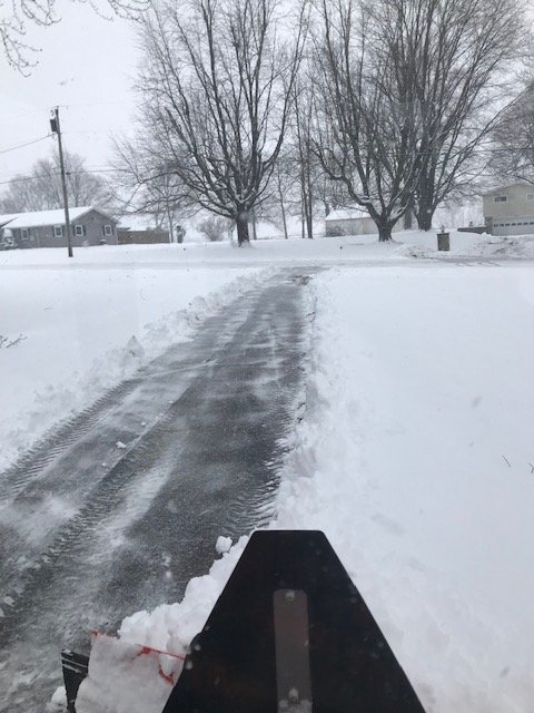

I have a BX2370 and don't have any slopes to contend with so YMMV. Other than the really heavy wet sticky stuff, I haven't had a problem with using a rear blade. And, I can also use the bucket if it gets too deep and wants to push me around. Also, a back up camera and mirrors will help save your neck when using a rear blade.
HTH
