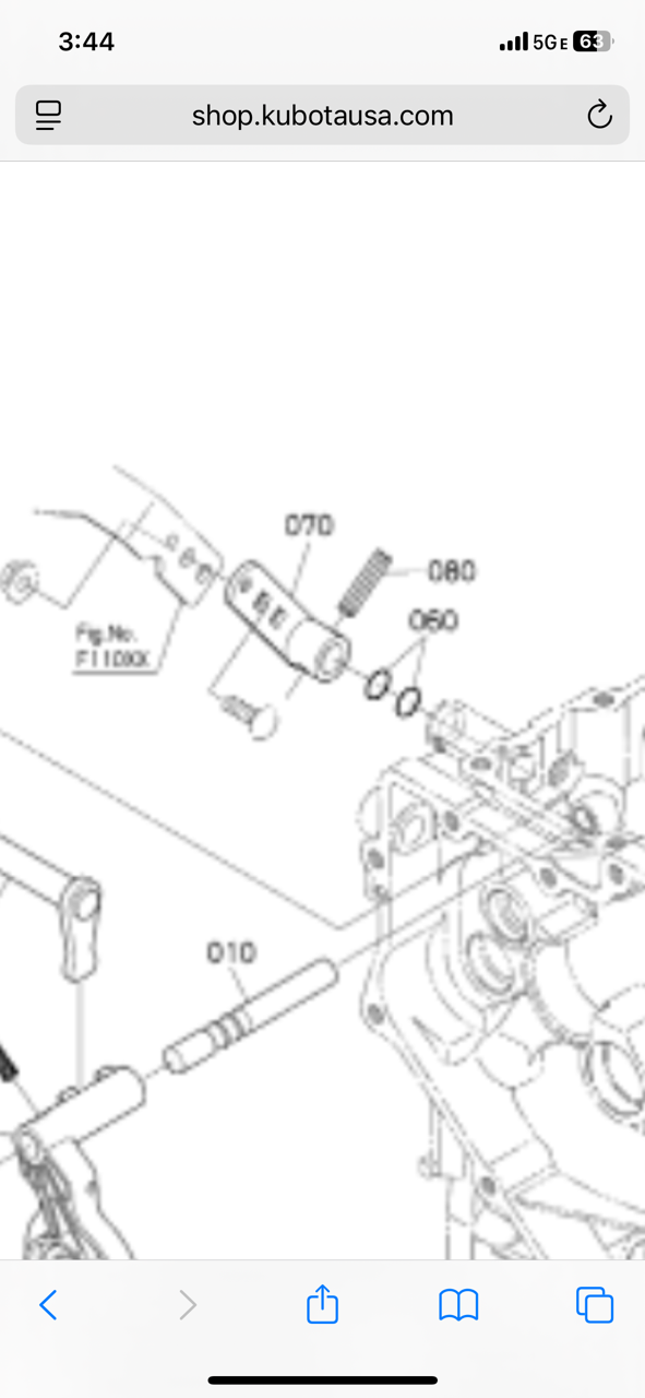

Not doubting your dealer, but I’d check that roll pin #80 is there.

If you can shift the lever and feel the detents, then a broken shift fork is a definite possibility. On the other hand, the roll pin mentioned is much more likely to break than is the shift fork.

You should go to dealer and examine roll pin 80.
If pin is broken, show manager the pin then INSIST he put what he saw (broken pin) in writing. Then load tractor and take it home. I wouldn't allow them to touch my tractor again even if it was free.
If pin is not broken I would take tractor home and pursue truth on powertrain warranty. If warranty has expired I would shop around for repair proposals.
