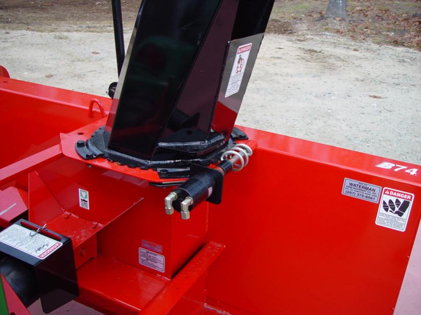

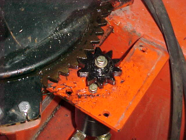

Well actually... they have. Just their vs. costs near $1k !!!!
I've seen them (pics below) mounted vertically as well w/ a small gear driving the chute sprocket (Kubota Gear pt# 70060-00698 about $40.).
I just need a definitive answer on the required specs. for the motor.

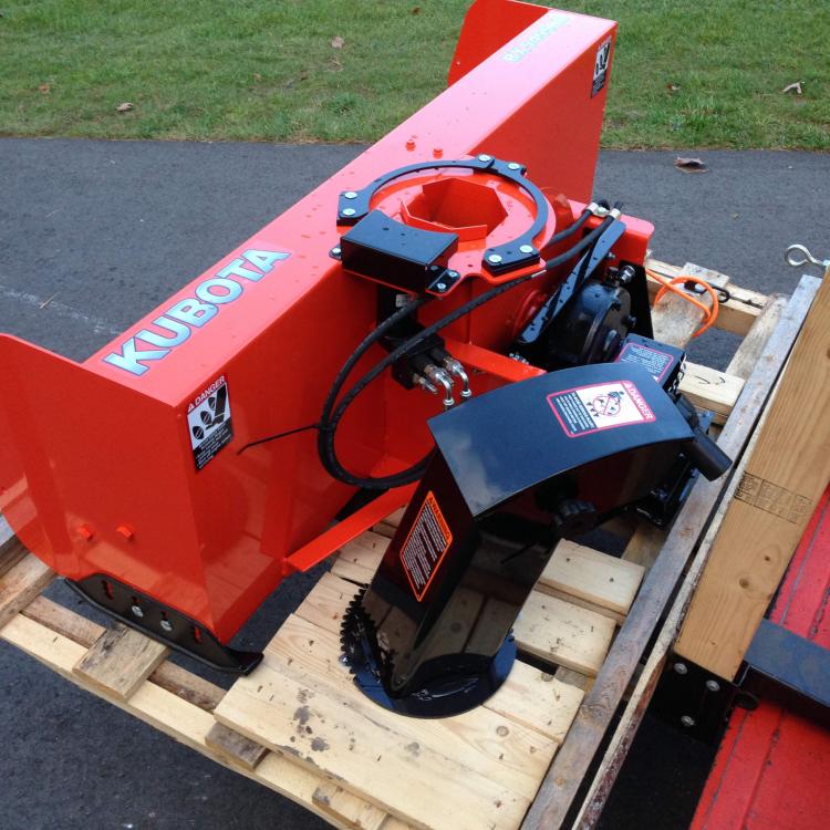

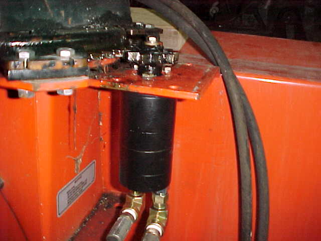

This one (vertical mount) is the config. the factory uses - direct gear driven.
Difference is (on the 5455 as shown in 1st pic) it's mounted on the left side of the chute. And it has a cover to keep it clear of snow & ice buildup. I see different advantages to both. A horizontal mount requires fab-ing a motor mount/bracket and employing a LoveJoy coupler to mate up w/the worm gear. (pic #2) It seems to reason this setup would allow the use of a smaller (cheaper) motor that spins at a higher rpm. I believe the 5450 is already config'd for the vertical vs. By removing the worm gear & it's mounts, and sourcing the correct sized motor, w/Kubota Gear pt# 70060-00698, it's a simple bolt-on installation.(pic#3).
Either way there are a dozen or so hydraulic motor candidates on eBay -
I JUST NEED THE SPECS. OR A PT# !!!!! PLEASE ...ANYBODY???
