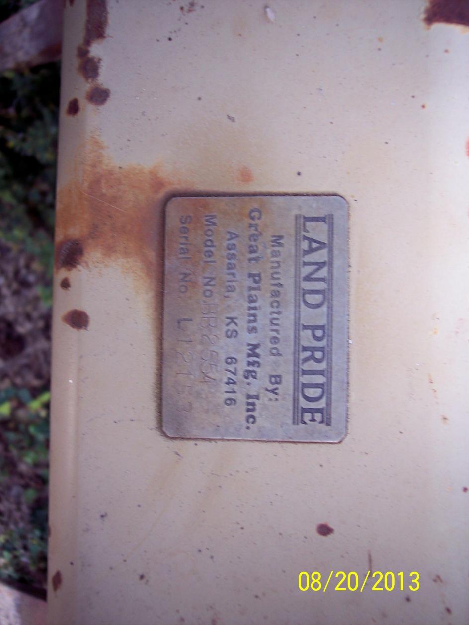

Sorry if this has been covered before.
I would like to know if anyone has any experiace with what box scraper size is best suited for a BX 2370.
I have a chance to pickup a landpride BB 25 series box scraper 54" wide but it just looks a bit too much for my tractor?
And the 3pt mount is 27" wide.

I use a 48" LMC on mine. You may have the wrong model number as LP site doesn't offer a BB25 in 54, only the BB15.
You can probably get by with a BB1554, but it won't be ideal.

Apparently they use to make a BB2554 because this guy has one for sale and I saw the ser# tag and it says BB2554
